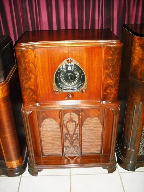

From THE Zenith collector site, Old-Radio-Zone, here's his 15U-270 in a Walnut 'finish':
Here's Ken G's very nice 15U270 (walnut) or perhaps a 15U-271 (mahogany):

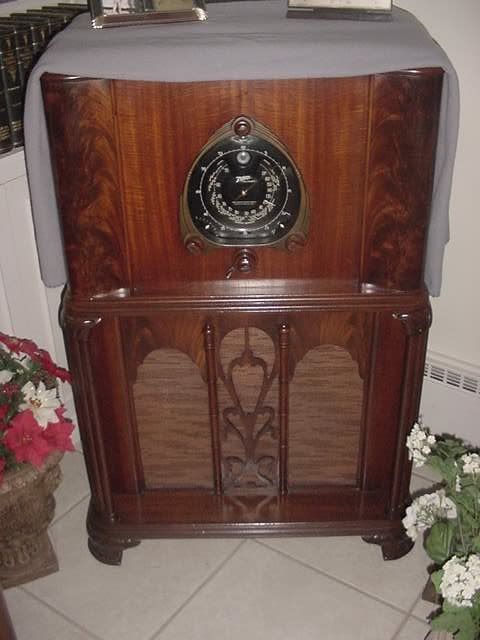

And here's mine: I was told it was a 15U-271 (Mahogany) version:
I can't really say i can see much difference BUT perhaps there is some wood grain difference on the vertical curved sections on the sides of the dial.
It appears to me that Ken's and my set are more similar with the wood grains than the view of the ORZ photo. The Toners appear to be very similar in color but I guess I really don't know and that's why this thread to discuss in more detail everyone's views.

The main difference I can see is that the the Old Radio Zone cabinet and Ken G's cabinet both appear to have a burl veneer on the front panel. Your cabinet appears to have a straight grain veneer on the front panel.

The cabinet in the first picture has walnut veneer, the next three have what looks to be mahogany or some species with similar grain. The first cabinet looks like it was refinished with lacquer or some other gloss finish,without shading (but that may be just the picture) The second cabinet looks like it was stripped and tongue oiled, so you can't really use that as a reference at all. The next two photos look like a very good original cabinet, or a top notch restoration (or are they the same set?) It looks like what they were referring to by "finish" was actually the species of wood used in constructing the cabinet and not simply the colour.

This set is walnut. note the distinctive curly grain of the flat panel around the dial. The walnut burl trim and crotch mahogany trim can appear to be very similar, but plain mahogany never exhibits the curly grain characteristic of walnut.

To the practiced eye, the difference between the crotch mahogany used for trim on your set and the walnut burl used on the other mdels is readily apparent IN CLOSE UP. the principal difference is in the apparance of the medullary rays of the geain of the wood. this does not show well in a photograph. Besides, the general effect of the two trim woods is similar.
On the other hand, the flat panel behind the dial on your set is very clearly quartered mahogany. Note the pronounced regular "tiger stripe" effect. This is a sure sign of rift-cut mahogany.

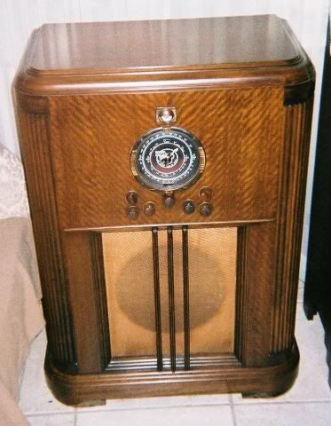

Thank you all for some good and enlightning discussions. Here is another mystery from my own collection:
Mr EH Scott often gave away a free cabinet in slow times to keep his factory busy. Usually this was the low cost $20 Braemer cabinet, available supposedly in ONLY Walnut per original order forms and brochures.
I have 2 Braemers and the 'finish' of the 2 could not be more different as seen below.
Here is the 1st one, circa 1937 Phantom, and an obvious WALNUT wood and toning:
So, what is this one then, a circa 1940 with a Masterpiece chassis ? Different cutting method or a different wood perhaps ?
