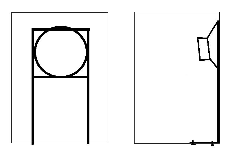

Here are the cabinet restoration photos- The problem is going to be mounting the heavy speaker. The new struts won't hold it. I'm going to try using a saddle or shelf.

Terry , looks good . How about mounting extra long metal strips behind the 2 speaker bars inside and screw them on ( use short screws :o )
Maybe something like this:
You could have the base take the majority of the strain.

Salval wrote:
I'm exploring every option. That is one. There are a couple of problems with that. A metal, or wood strip might affect how the grill cloth fits, and drilling the holes will be difficult. My furniture guy tried some thin metal strips across the repair points but that's just going to move the stress point down.

The metal bars dont need to be that long , only about 2'' longer than the speaker grille bars . It needs to be out of thin metal no thicker than radio chassis metal .
