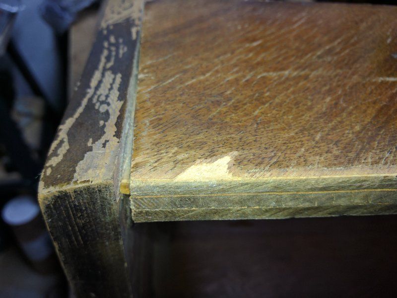

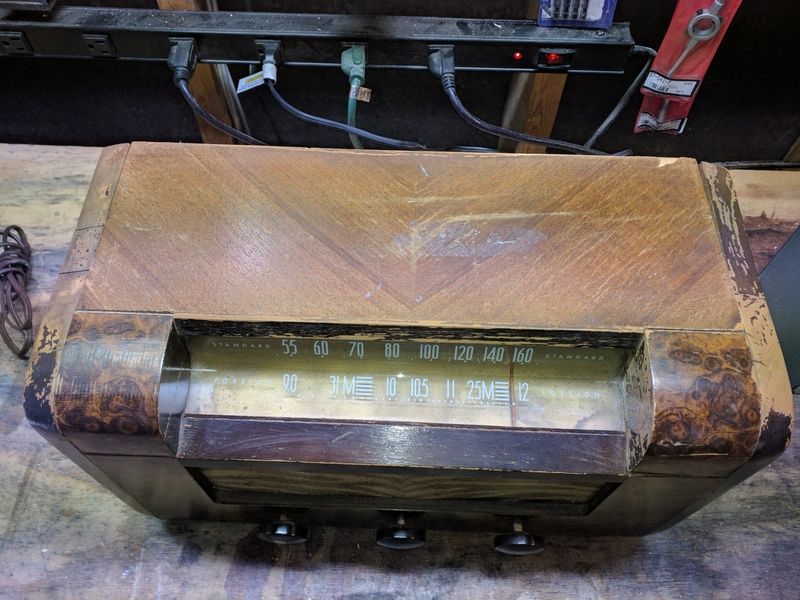

I am beginning the restoration of an RCA 66X3 tabletop radio of 1946 vintage or so. Right after I bought this radio I noticed it in a movie. One is clearly visible in the movie Coal Miner's Daughter in the kitchen scene after the family moves to Washington state. No one can miss the tiger stripe grill cloth of this set!
I bought this unit at a yard sale in Denver about 8 years ago. Now it's time to bring it back to life. I have no idea what I am going to find with this one. I have never attempted to power it up or really look at it until now.
It is a 6-tube set and covers the broadcast band a section of the shortwave band. The tuning dial on this radio is pretty unique, with the scalloped glass. This is all intact and not cracked. The dial printing is in good shape, while the dial background is just a gold-painted, curved strip of steel (but may be aluminum. I haven't looked closely yet). The tuning capacitor and indicator needle move fairly smoothly. It should, since it employs ball bearings! The cabinet is in bad need of some TLC. The face seems to be a photo finish, and possibly the sides of the cabinet as well.
This shows the top finish. There is definitely a veneer top layer, but the wood grain is VERY thin. Could this be photo finish grain too?
Image showing a closer view of the veneer top, including some damaged veneer. You can see where the "grain" has flaked off along the edges. (Not the obvious v-shaped chip from the veneer itself) This is what leads me to believe it might be photo finish on top of the veneer.

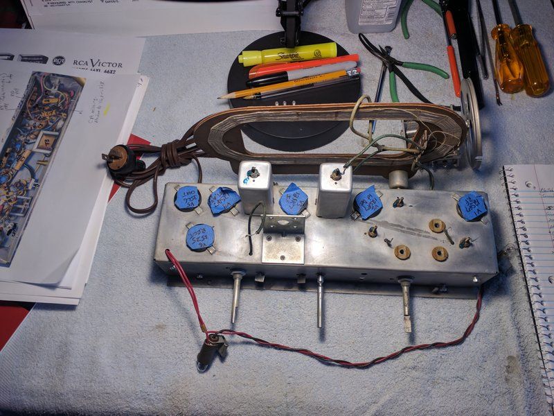

I believe someone may have had an idea to repair this radio in the past as all six of the screws holding the chassis to the cabinet were missing. The three front-panel knobs were all that was holding the chassis in place. The chassis came out easily, revealing a substantial patch of asbestos heat shielding that encompassed the entire underside of the chassis. This was all safely removed and disposed of outside. The chassis is dusty but seems to have no damage. Underneath revealed what seems to be all original components. I intend to replace all capacitors without question...and will check all resistors, replacing those out of tolerance. The left-most knob is firmly stuck and does not move at all. I haven't begun wire tracing yet, so I am not entirely sure what it's function is yet. The right switch has three positions, and is likely the on/off and band selector switch. The center is the tuning knob. So I am not sure what the left knob does yet!
Rear of the removed chassis.
Underside of the chassis, showing the phono input. A switch for the phono mode is obviously part of the switch mystery! Which one is it though? Time will tell...

The top is wood veneer. It is normally that thin. You can repair that damaged sports by using wood glue and tightly clamping an oversized patch with the right grain match, then sanding down (slowly and carefully) to excess. The patch will precisely conform to the jagged edge, helping it blend.

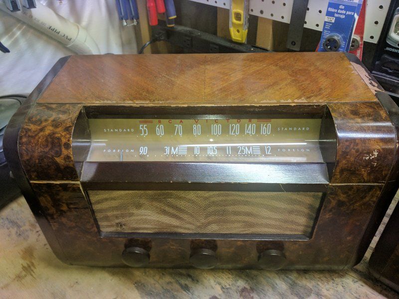

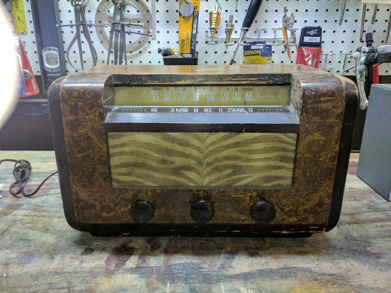

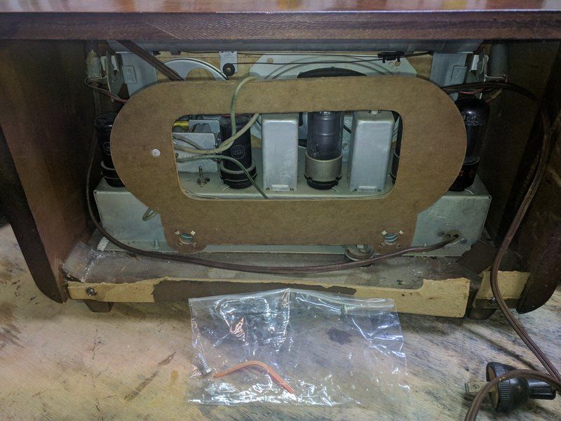

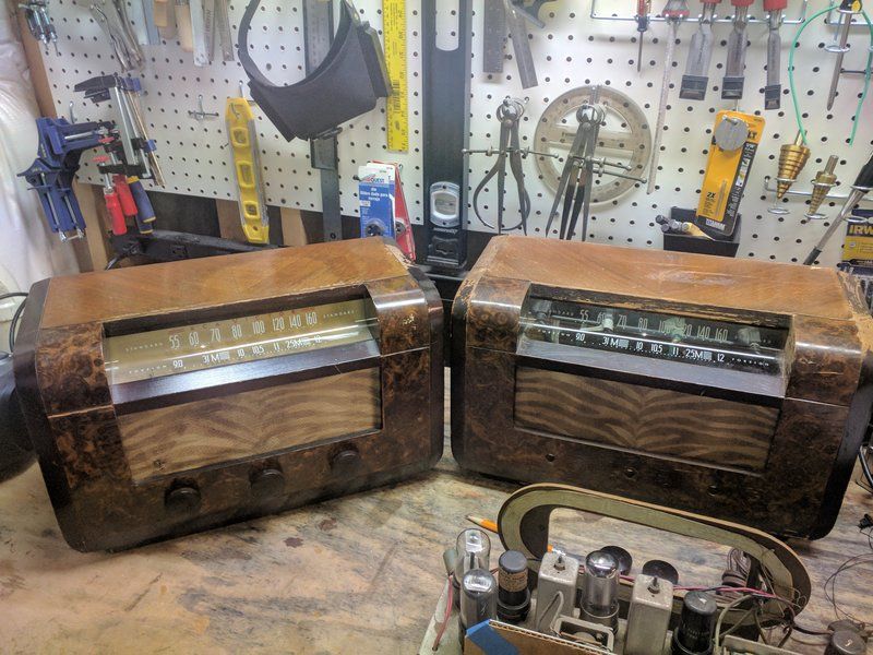

As promised, here are a few photos of the "new" 66X3 I picked up Sunday night. As I noted earlier, the cabinet on this one is in a lot better shape than my original one- especially the left side of the cabinet.
Here is a view of the pair side-by-side. The new unit is on the left.
A closer view of the "new" radio
Rear of the chassis in the cabinet. The "Golden Throat" sticker on the rear panel (not visible) is in better shape on this unit too.
I will begin assessing both radios and figure out a path forward. The first priority is to get the best-of-breed in parts between the two for a fully functioning radio. But unless there is a real showstopper I plan to get the second radio working as well. I figure the second one might be a little easier after having completed the first one! That is, unless there is a component or two that are really destroyed...like a transformer! Time will tell...
Bryan

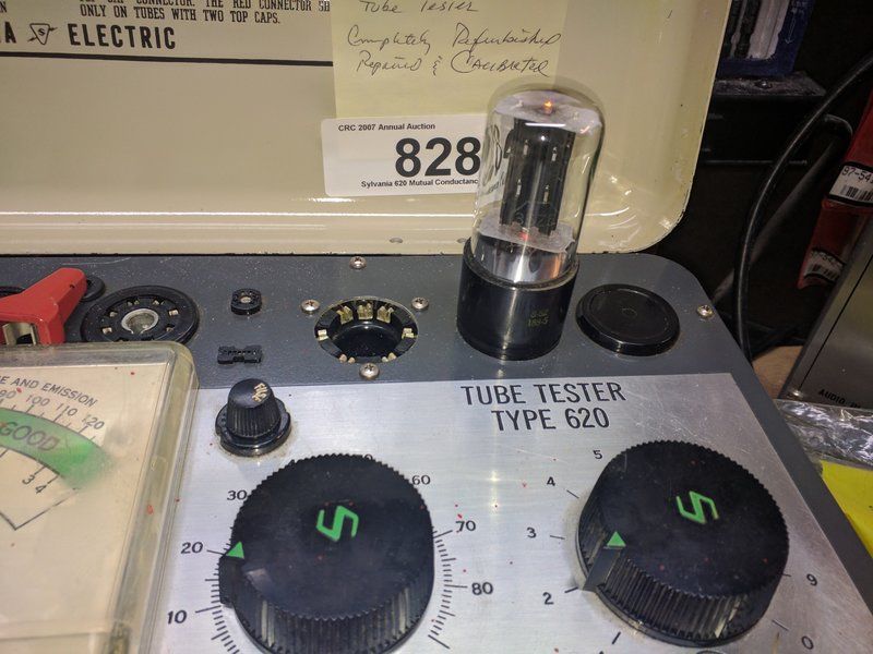

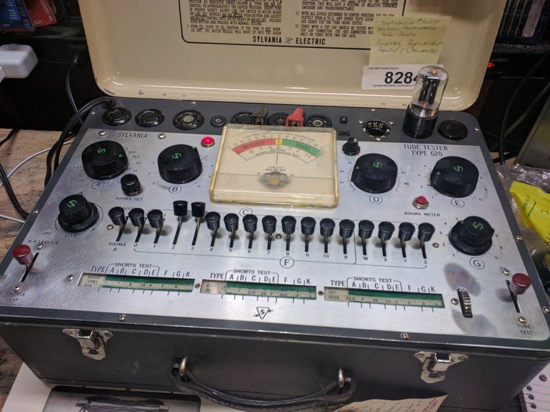

Tonight's update...tube testing! All 12 of the tubes from the two radios tested good with my trusty old Sylvania 620 tester. I acquired that when I lived out in Denver 10 years ago. It was completely restored by Dave Boyle, the Colorado Radio Club president at the time. He put it up for bids at the annual club auction and I was lucky enough to win it! Later on I also bought an Eico 320 sig gen from him...also restored. I'm sure that will show up somewhere along the line in this thread eventually!
One of the chassis' had a substitute for the 35L6 audio amplifier tube. Instead, it had a 50L6 in the socket! I can't imagine that would work with a 15V difference in filament voltage. From what I've read, including a thread here on this forum, they are both beam power amplifiers and basically comparable except for the filament voltage. I have no interest in modifying circuitry to accommodate the extra 15V requirement for the filament. So, I'll be getting a proper 35L6!
Here is a photo with a 35Z5 rectifier tube under test...
And another of the entire tester.
From here on out for a little while it will be grunge work cleaning and tracing out wiring and components...
Until next time!
Bryan

That’s a pretty common tube substitution 50l6 in place of 35l6. Many prefer to do it due to today’s higher line voltage. There are several threads on it in the past if you want to look them up. If it were mine I would leave it.

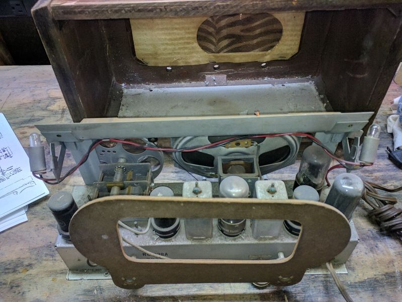

Life has intervened, keeping me from doing much this week. However, I do have an update and a question for the group. In my original post I mentioned that the radio had an asbestos sheet beneath the chassis. That really didn't make any sense to me as any heat issues would be noticed on the top of the cabinet above the tubes in the chassis, not below it! This pad is actually referenced in the schematics. It is not asbestos. It is a dielectric material called fish paper. I had never heard of this prior to reading it in the schematic. It seems it was used as an insulator between the chassis and the cabinet. So now the questions...
Why would there need to be an insulator between the chassis and a wooden cabinet?
In the references I could find on the Internet about fish paper, it does not seem that it contains asbestos. What is it actually made from? And more importantly, now that I have thrown it away, do I need to replace it in the radio?! Grr...
Bryan

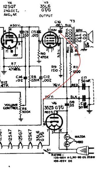

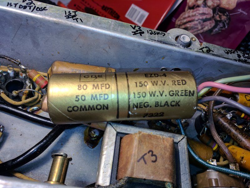

Here is the schematic for this section as printed:
Here is the schematic showing how C16 is actually in the circuit:
And this is the cap in the chassis. C19 was removed by the previous owner and is not visible:
It seems the factory upsized the filter caps as well. And the values and configuration are different between the two chassis' I have on-hand! One of them actually has the specified 50uF/30uF "can". However, the 30uF cap has an additional 20uF/20uF in parallel piggybacked on it. The values of the filter caps in the other chassis are 80uF and 50uF! They both appear to be factory installed. Here are some photos showing this:
Which values should I go with when I replace all these capacitors? Per Schematic or as-installed?

Update: I just received updated factory schematics for this set from ARF advertiser Steven Johnson and these do have the as-built circuit configuration I painstakingly (idiotically?) detailed earlier for capacitor C16. With these schematics I should be able to get to work in earnest!

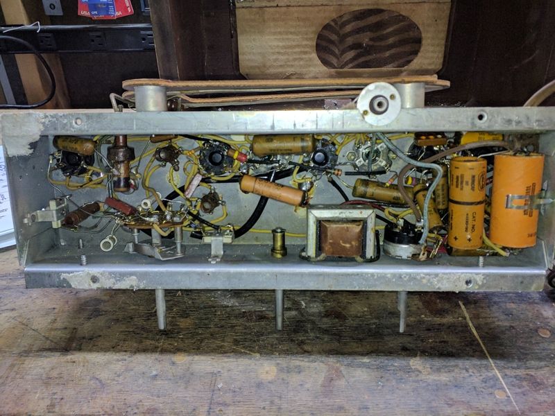

I have completed the tracing of all the circuits in the schematic. All had the correct continuity and resistance readings where appropriate. I have located and marked each component for ease of finding them later. This is mostly done using a printed photo of the chassis annotated with the component enumerations. I've begun cleaning up the chassis and have removed the variable tuning capacitor and speaker from the chassis to help this process along. Here is the stripped down and partially-cleaned chassis:
Once the chassis is completely cleaned, I intend to use a clear finish on the steel chassis components. I'll mask off the IF cans (which are aluminum), tube bases, and other openings for this. Since there was no fancy finish on this chassis, I am not going to paint it. I'll probably clear coat the frame of the tuning capacitor as well, but I'll mask off the vanes and other critical areas for this.

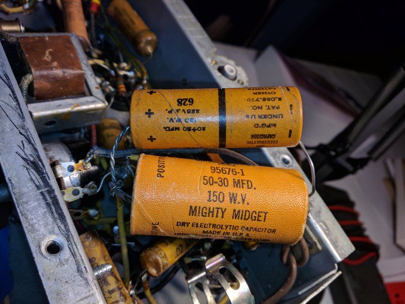

First, I will be replacing a bunch of components! It's time for the old wax/paper and electrolytic capacitors to go. I will likely replace many of the resistors as well. If their values are way out of tolerance, they look burned or flaky, or I just think they should be replaced, I'll be pulling them.

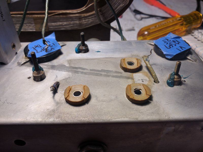

Where can I find replacement rubber grommets for the variable tuning capacitor mounts? These are the same on top and bottom of the chassis. A steel threaded stud extends through the middle for the mounting bolts. Any help locating a supplier will be greatly appreciated!
