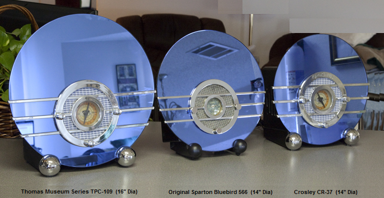

May I suggest getting a reproduction radio. Unfortunately, most repro radios don't match up in performance to the actual antique radios that their trying to be a copy of but some examples are fairly good in performance, styling, and construction. My favorite, and I seriously think you should look into it, is the solid state Crosley CR38CD Blue Mirror Radio. They may not be made any more but they can still easily be found on Ebay and other places on the internet.
Crosley CR38CD
https://www.amazon.com/crosley-cr38cd-s ... b0000dhvop
Crosley CR38
https://www.radiomuseum.org/r/crosley_c ... radio.html

Solid state reproductions were also made of the smaller Sparton 566 "Bluebird". These can readily be found on Ebay.
Sparton 566 reproductions. 3 different AM/FM examples. I think one is considered to be better then the other two but I can't remember which one it is.

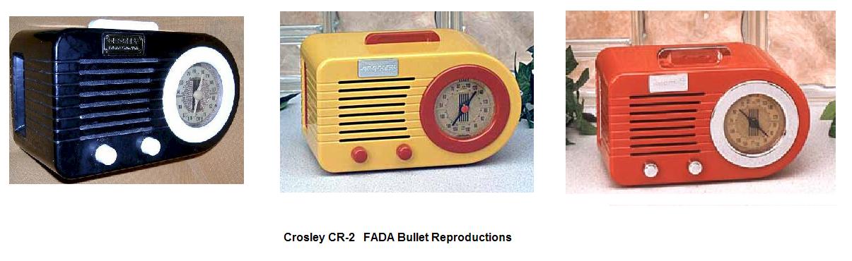

Other suggestions are the solid state AM?FM?Cassette Tape Crosley CR-2 radios that are copies of the Fada "Bullet" radios...
Actual Fada "Bullit" radios. https://www.google.com/search?q=Fada+Bu ... 0&bih=1070

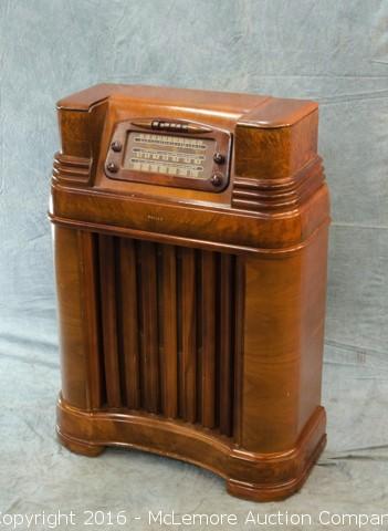

This is the setup that I would have.
1946 Philco 46-480
This radio is great in that it features a little bit of everything, AM, SW, and modern FM all housed in a prewar styled cabinet. Most people may no longer listed to AM but I'm pretty sure enough of them still listed to FM and this radio features it. There's also the 1946 Philco 47-1230 which is just like the 46-480 except it has a built in phonograph and a simpler cabinet.
The Philco would be fully restored with all new capacitors, all new metal film and ceramic NTE resistors, a thermister for a gentler startup and a fuse that is rated just above the actual working current draw. In fact I'd probably make a special black box that would connect in between the radio and AC wall socket. It would feature of it's own built in thermister, deluxe line filter, ground connecting post, be double fused, and use a good three prong AC plug.
My homemade protection and filter box. I need to replace the AC socket due to the chip that it has.
So, this is kind of how I would set up such a media system which incorporated an antique radio.
For WiFi hookup, I'd choose one of these Bluetooth receiving/FM transmitting transmitters.
https://www.ebay.com/itm/FM-Transmitter ... SwXSJXOaTF
WiFi and internet streaming will always sound better if transmitted by FM. Just tune the Philco to whatever assigned FM frequency that you have set up on the transmitter and a person can listen to their Ipad, smartphone, or PC through that old Philco radio. They can easily tune away to some other frequency in order to listen to something else that's on FM dial. I think it is more fun to tune in an external media source then to listen to it via a system where the media is piped in through a hardwired system.
