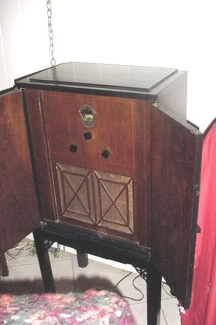

http://i268.photobucket.com/albums/jj22 ... CT0126.jpg
lets try this

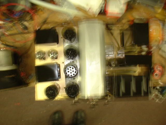

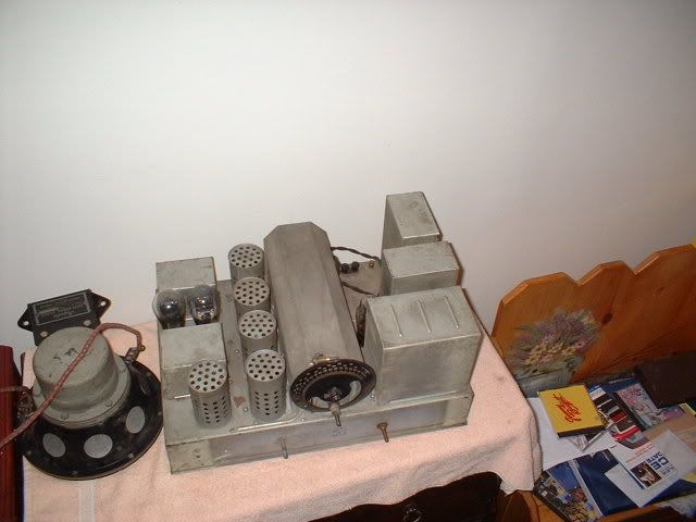

Count me in with the G-G Majestic fans - I have a 1930 model 90 and a 1930 model 93, both with the 90-B chassis.
Yes, it's heavy...and yes, they sound wonderful!
A few shots of the 90-B chassis:
The mind is like a parachute - just because you lost yours doesn't mean you can borrow mine.

thanks huggybear for getting the pic on site
oh and please pay no attention to my ultra clean shop :oops:
as you can tell im a little behind on my bi weekly cleaning :lol:
since i was unable to find a pic of this type of cabinet anywhere on the net should i put this in the gallery when its restored ??

You did the hard part of getting the picture here. Especially if you're using Photobucket, it's really easy.
Under each of your pictures there are four lines marked:
Email & IM
Direct Link
HTML Code
IMG Code
Click on the line that says IMG Code. Boom, it's on your clipboard.
Go into the message where you want to put it. If you have a PC, hit <control> V (at the same time). If you have a Mac, hit <apple> V at the same time.
All I had to do to make your picture show up was to add [ img ] (without the spaces) before it and [ /img ] (without the spaces) after it.
The old Majestics are fine sounding radios. I'm not surprised they sold well. Built like a tank - and weigh about the same as one too.

Sorry to hijack the thread, but this is my Majestic 90 (with Havana guarding it)
This radio was rescued from the trash - twice! It was a very sorry sight when I got it. Someone made a horrible attempt at "shabby chic" with it. I wish I would have taken some "before" pictures. It did not have legs, I threw these on. These pictures were taken while I attempted to clean the paint from the cabinet:
This is the chassis after I finally got it playing. BTW, the chassis I posted before is out of my Majestic 93. This is a 90.

tubenutt wrote:
OHHH! Huggy! That looks WAAAAAAY better than mine in the underchassis picture. That is a neat job....beautiful!! :D Mine is a Majestic 91 and it sits... still crushing carpet fiber over there. When I finished mine, I still didn't nkow to neutralize my Neutradyne! And you know what a job it is to remove that behemoth chassis. You need help just to turn the monsters AROUND! But they DOOO sound good! :wink:
I'm always saying, "Well, I'll get to it soon." Right now, it has a LOT of "birdies" in the output! :lol:
YOU DA MAN!
Neutralizing it is a piece of cake.
Start at the back of the chassis and work your way forward. Pull out one of the #27s and wrap a piece of very thin tape around one of the filament pins. I used splicing tape, but most people can't get it. Use that thin clear packaging tape.
Plug the tube back in, put the shield on it, then adjust the neutralizing screw for MINIMUM volume. Then move to the next one, and the next one. It is best to do this using each tube that will actually be in that spot (due to variations in interelectrode capacitance). That's what I did - takes a little longer but you know it's right.
The adjusting screw on the 90-B chassis is at ground potential - I used a plain metal 1/4" nutdriver (I advise you to check it with a meter first in case I'm wrong!). But if you get used to this, then you get to work on a Philco, note that the trimmers on a Philco are HOT!! Don't ask me how I know this...
It's really an excellent sounding radio.
