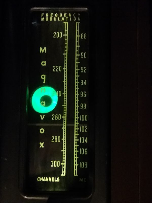

For those who deal with radios that have an edge lit dial and the original material used to block the light from going behind of or in front of the dial has disintegrated or otherwise became unusable here's a solution.
Black double sided tape.
Either stick to the dial or the chassis leaving the backing on the tape to facilitate easy dial glass removal should that be necessary and use however many layers is required to provide a good seal between the dial glass and chassis.
Here's an example.
Notice how the light only shines through the dial glass edge and not in front of or behind it.
Also notice at the bottom of the picture how any smudges, dirt, oils ETC... from handling the dial scale are visible given it causes a spot of light to be seen where the contamination is.
Here's a picture showing how it was done.
One layer of tape in front of and behind the dial.
If necessary the backing can be removed on the rear layer of tape if it is desired to hold in the dial glass more securely.
This example is with LEDs, but will work just as good with regular incandescent bulbs as well.
Another tip for edge lit dials when desired to convert to LED is to get the LED fuse lamps. Once the end caps are desoldered and removed, you then have a circuit board with three LEDs on it, a dropper resistor and a rectifier which can be placed right against the dial's edge then epoxied in place and run directly off the 6.3Vac heater voltage using a dropping resistor in series with the bulb to keep the dial as bright as it was originally, brighter if it was a little too dim stock or dimmer if it was too bright stock.
Here's how it was done. A little double sided tape on the PC board holds the LEDs to the dial and allows for final positioning before epoxying them in place.
The LED boards are small and thin so if you run into an issue where only one dial lamp is used and the dial isn't evenly lit you can do like I did and place a LED board at the other end of the dial.
If you notice looking at the first picture there is a small problem doing it this way. That is if there are any dial glass holders on the side of the dial glass and they are not near the bottom or top side of the dial glass it may be in the way of mounting the LEDs properly and as seen in my example it affects the lighting of the dial where MC isn't as brightly lit as the rest of the dial.
