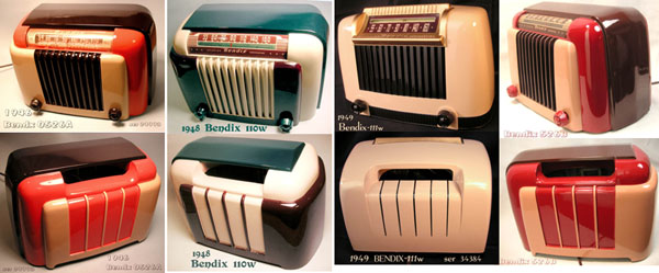

Glue it together... and paint it.... you'll love it.
The 1st one on the left in this picture was shattered and re-glued... now look at it!

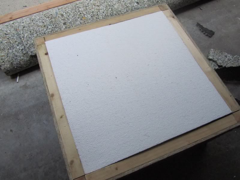

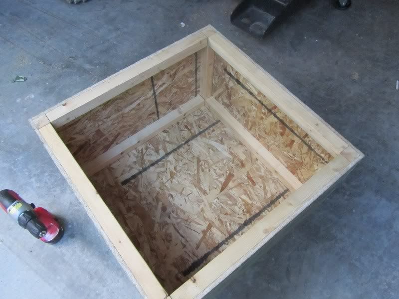

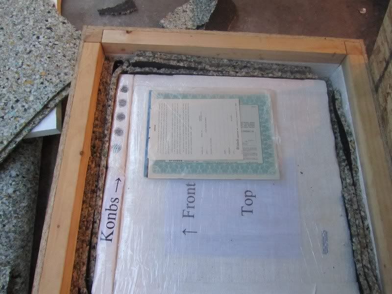

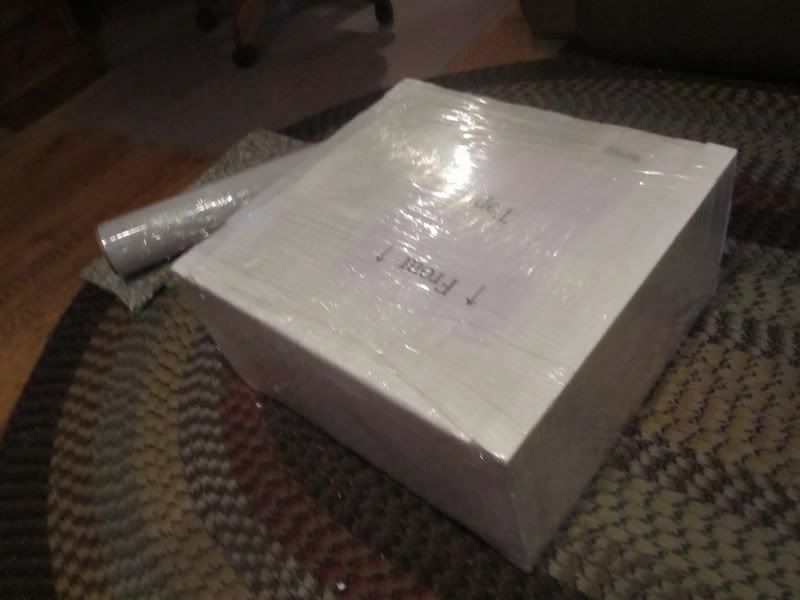

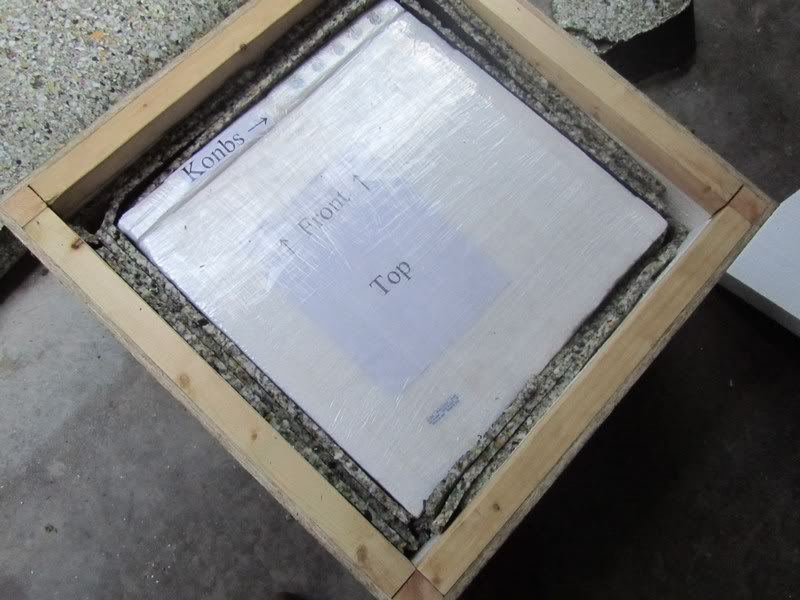

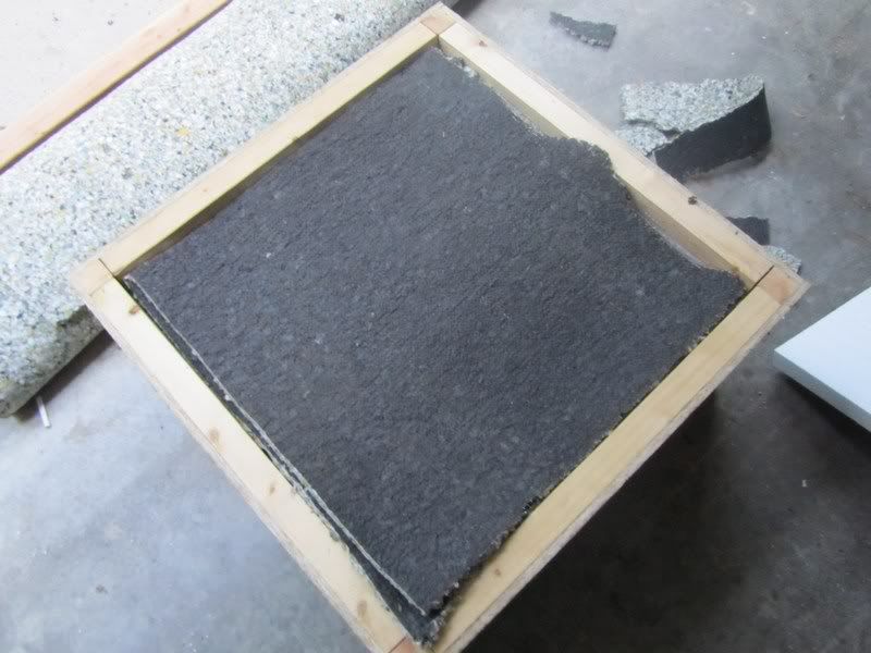

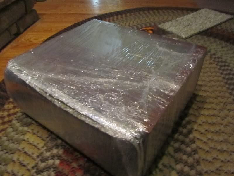

This is my method for shipping UPS and have sent out over 20 McIntosh and other audio gear out this way and buyers have been very pleased with the outcome. Note the list below was my first method I have how added a step between steps 2 and 3 Many layers of extra strong large bubble wrap
1. Knobs removed
2. 3 layers of carpet padding over glass with 1 layer cut out around the gauges and knob pens
3. Shrink wrapped
4. 1 layer of 1.5” Styrofoam
5. Shrink wrapped
6. Knobs put in 1.5” Styrofoam
7. Taped to the front of Item
8. Wood Box made with 1.5” corners and 7/16 sides
9. 1.5“ Styrofoam put in sides and bottom of box
10. 3 layers of Carpet Padding put in Bottom and sides
11. Item Put in
12. Manual put in
13. Couple layers of Carpet padding put in
14. Layer of 1.5” Styrofoam put in
15. Wood top put on
16. Labels put on all sides saying Fragile and arrows pointing to top, Top labeled fragile and this side up, shipping address attached to top

What are Konbs? :wink:
