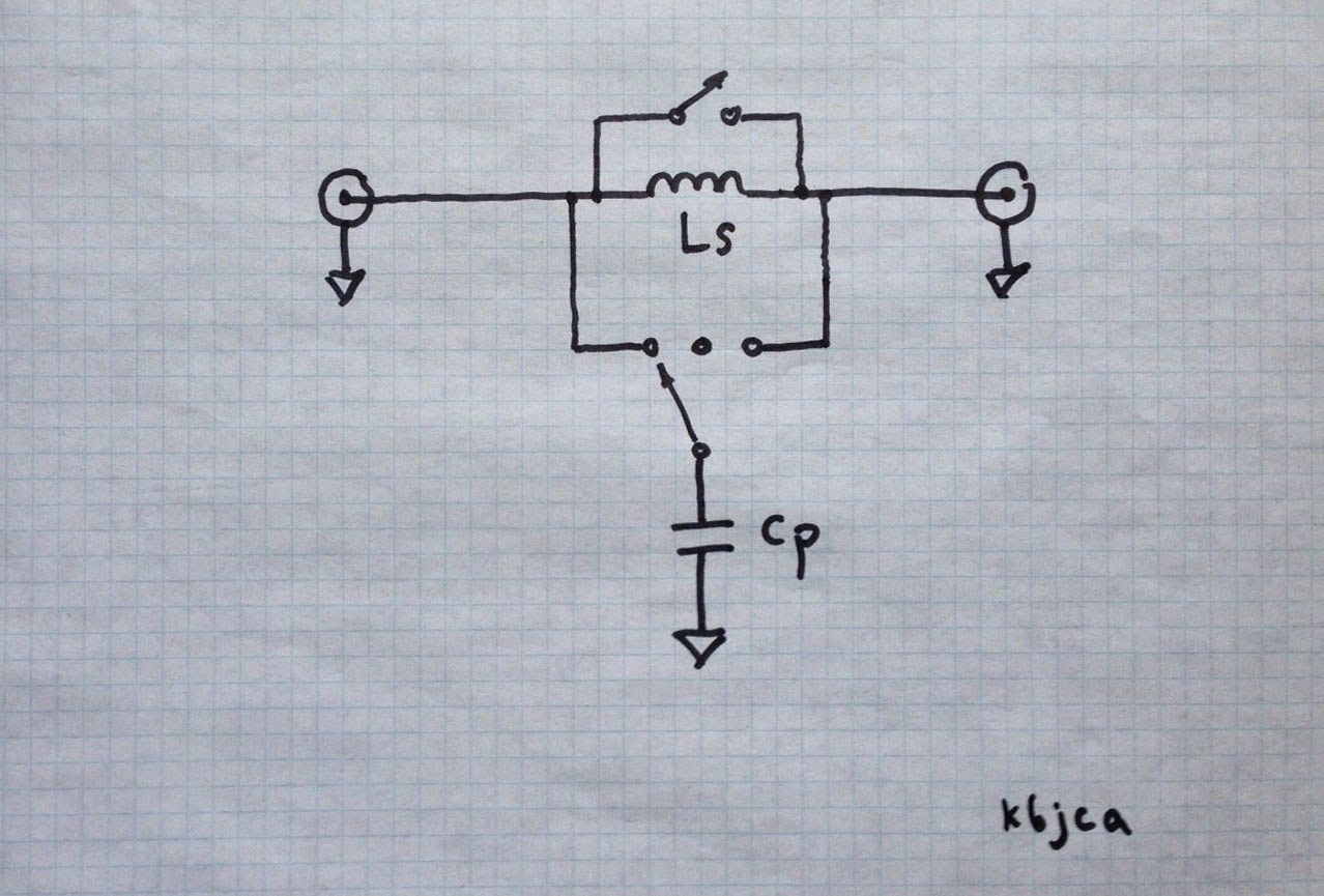

 Post subject: Re: Modifying an old receiver to double as a wave trap.
PostPosted: Apr Sun 23, 2017 7:06 pm
Posts: 1763
Location: On the Left Coast
Try an antenna tuner like a 'L' network for simplicity.
Image compliments of K6JCA.
With a tapped coil and a variable cap switched to either side you can have a high pass or low pass filter. Adjust tuner for max signal strength of the shortwave station you are listening to.
And you don't need the coil shorting switch unless you want it.
Here's another version.
Here's one I made for a little low power ham radio I built.
The coil is 1" dia and 32 turns but I don't remember what the turns per inch were. Maybe 12 T/I?
The variable cap is for a transistor radio. Both sections ganged together for about 300 pf total.
