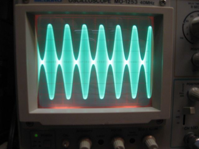

Thanks Peter. I guess RFC is a choke? So the RF and AF are simply added together?
Well... I'm no transmitter xpert guy... so I can't say exactly ... but typically two frequencies mixed in a tube do create a mix = the sum, the difference and the original two.
But I do know what a modulated radio carrier looks like coming out of the antenna so:
I think, it looks to me more, as though it works this way:
It feeds the audio signal to the suppressor grid to make it more or less positive.. so it's like the audio signal on the suppressor is acting to help increase or decrease the flow of the electron stream from the cathode to the plate... so it's modulating the carrier. More signal/less signal.

Technically dual control tubes do not have a suppressor grid(though is often still called as such), it becomes a second control grid or G3... Some tubes with suppressor can be modulated, but it requires extra circuitry and usually a large amount of audio input, results are generally far from optimum... The 12CS6 is a Hextode but still has two control grids as does the dual control pentodes like 6888, 6GY6, 6HZ6 ect... And lets not forget my current favorite, 9KC6... Requires 9v for heater and a G3 bias supply to really perform but results are excellent... Would have been nice if there was a 6KC6, but it only comes in 9v flavor...
In real life music will look something like this(can't remember what song was playing)...
Apparently it was full of high notes as a 1k tone looks lie this...
