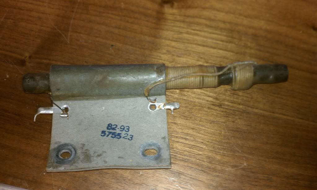

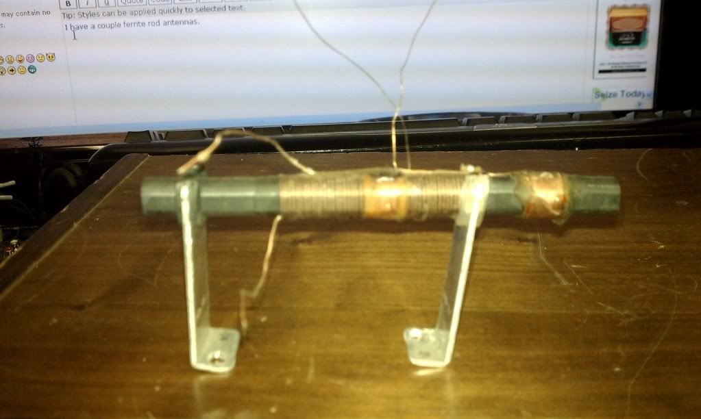

I have a couple ferrite rod antennas.
Has one coil
Has two coils one of which was used to allow for connection of an external AM antenna.
Will either of the two work?
The single coil ferrite rod I can mount on the back of the chassis on the outside if necessary.

Either one should work just fine. Of course try both to see if one gives superior performance, and try using an external wire or whip antenna with the second one.

If your ferrite rod has two windings, use the one with the most turns for the tuning circuit. The smaller number of turns can be connected to antenna and ground. For local stations, the rod alone may be enough antenna.
