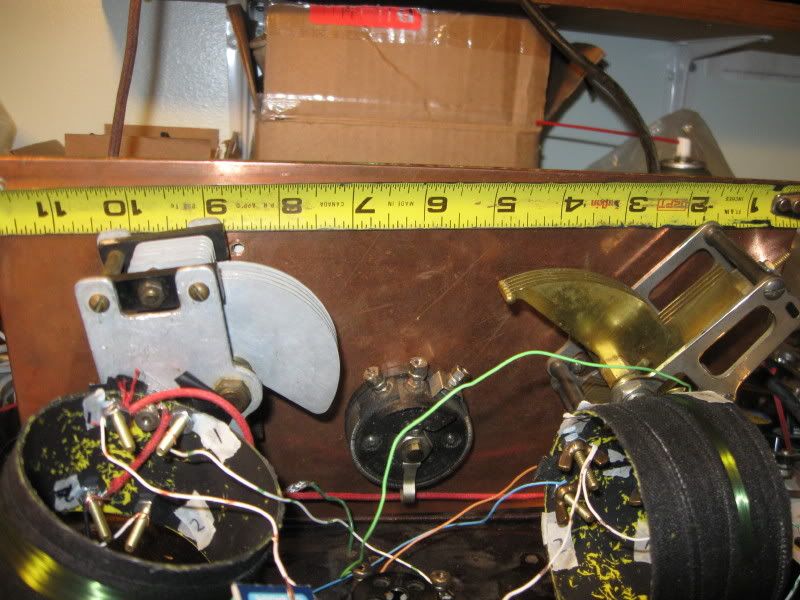

I am working on a One tube reflex project from the mid 20's and the call is for .0005 mfd variable condensers. I have a couple kicking that I used but don't know if they are the correct value. Can I accurately attach my Cap meter and read their result?

.0005 mfd condensers were typically 23 plate, +- a few.
 Post subject: Re: Can a variable condenser be accurately measured???
PostPosted: Mar Sun 18, 2012 10:49 pm
Joined: Jun Sat 02, 2007 1:37 pm
Posts: 1341
Location: Ennismore, Ontario
When you say plates do you count all the plates? Just the Stator or just the Rotor?
All plates counted I am using would be 9 and 11.
Brian
I came into this world with nothing...
I have been able to keep most of it.
PostPosted: Mar Sun 18, 2012 11:05 pm
Posts: 4880
Count just one set of plates... either stator or rotor.
Your count would indicate a considerably lower capacitance than 500 pF, unless your plates are huge.

The plates are different sizes and shapes...
