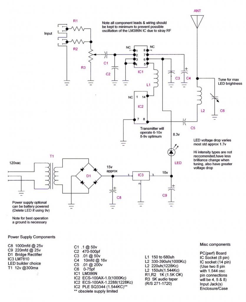

I've spent more time in development with this little guy than most of the tube units... Sound quality is very good and the current drain at 9v is only 11ma, so can be easily powered by a std 9v battery... The coil coupling the audio to the osc is very important, without it current draw is increased by 60%, is essential for good life if using battery...
Unit is built in a discarded satellite tuner... The meter is in series with B+ so takes place of tuning LED on schematic...
On-off sw & gain(level) are operational... Single lighted LED indicates standby or both for power on...
My unit is built semi-modular, board can easily be removed for service or modification... Plug with brown, orange and red wires connects to the power indicator LEDs(has standby and in operation modes)... Audio is fed from gain pot on front panel through the large connector and one at it's upper right connects to ammeter on front panel(in series with B+), lower plug connects ant tuning cap... LM7809 regulator installed at angle for cover clearance...
Large black item is a cover over the line fuse also has a scrap piece of pref board Velcroed over 120v connections to power transformer...
Better shot of board & tuning cap, antenna peaking performed from back panel...
Belly shot of the PCB and 110ma @ 10v xfomer...

I've tried using a sq wave from my signal gen and as long as the trimmer cap will tune down to 10pf or so(padders usually won't adj completely to 0), the 330uh coil will match 1228Kc to a 10ft antenna... Unfortunately I don't have 1228 osc to try, with a 1230 local, I don't generally keep one on hand... Worse case is the coil will have to be changed to 270uh or maybe a 47- 68pf added in series with the trimmer...

Looks like a nifty idea, but a couple of questions:
1. The ECS oscillator is TTL and rated for 5V +/- 0.25V. Does the modulated voltage exceed that?
http://www.ecsxtal.com/store/pdf/ecs_100.pdf
2. The ECS runs as a modulated oscillator in this application. Does than cause some FM? Probably even if it does, it isn't a handicap?

Audio signal required for full modulation is approx same PP as the DC input to osc... The LM386 outputs approx 50% of B+ so at 9v should be 4.5v, though I have seen variances between ICs close to .5v...
Norm has reasoned it should not be able to modulate 100% without killing the osc, but I can push it deep into over modulation and osc keeps running, of course distortion is a issue and seems to start being noticeable at approx 85% modulation... I have some older Dale osc that start "chopping" due to osc cutout at only 20-25% modulation, the ECS osc exhibits none of this trait... I haven't noticed any FMing issue(maybe in that last 15% modulation?)... Varying the B+ & using a counter, there wasn't a freq shift at any voltage between enough to keep osc running(less than 3v) to over 6v...
While I hate to admit it, basically this little Tx is so good it pisses me off... Spent hours building tube units(that I'll continue to use), can throw one of these together on a breadboard in just a couple minutes... If I could, only thing that I'd change would be a VFO or maybe a larger selection of IC freq...

For those who like waveforms, here are the modulation envelope using music and trapezoidal WF with approx 800cps tone... Both are at near 100% modulation...

The idea for this Tx isn't mine, giving credit where it's due, Mike Toon posted a slightly simpler version last year but I could not get much more than a bunch of squealing from the one I built... Mostly the problem was the LM386L IC I purchased that absolutely would not tolerate RF feedback from the osc... After trying a alternate configuration that modulated the ground side of the osc, I realized it was a RF issue and went back to a similar circuit as orig but with the added coil for isolation... From that point, it was come up with a good antenna conversion/matching network, in the end proved far simpler than I'd imagined...
