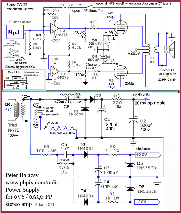

Both these PP amps are working beautifully in my living room and I LOVE them both. Hard to believe anything might ever sound any better.

So I decided that I want to try building that "Lacewood" Ver2 amp and if I build it as properly as the author describes I should have another true HiFI amp to try to see how it sounds compared to my 6v6PP types.
So I probably already have most of the parts but I had to order the new SE output transformers.
I see that the author took great pains and costs to build a hefty clean, no ripple power supply.
I built and designed the power supply for both my PP amps and I believe that I will be able to just incorporate the same 292v B+ supply I used in my 6V6 PP amp. I know it well and it only has 20mv pp ripple at +292V, and can handle 100ma. So I think that part of the build will be a "cinch" and will greatly reduce the build time and cost and chassis space.

He indicated he's planning to build another 'death trap' power supply directly off the AC line.
Flip:
Where did I say that? Huh huh??
There you go again making wild unfounded inferences where none was implied or stated.
(And... it's MY life anyway.... isn't it? )
So... you see... you are soooooooooooo wrong. Again.
lol
I specifically ONLY said that I intend to build the same kind of doubler supply ....but that's all I said.
... And you can clearly see that just as before, an isolation transformer is STILL not missing from this schematic is it?
So what's with you Flip?
...Why do you seem to always like to jump on things like that and always try to make inflammatory snide remarks? Do you just like to be a smart-alec guy who insults people ?
Try to remember Flip .... this is a supposed to be a friendly helpful forum. So please try to lighten up a little and stop making snide comments ... it's not nice, ... I'm sure your kindergarten teacher would be disappointed in you for this persistent habit..
OK?. :mrgreen:

"I believe that I will be able to just incorporate the same 292v B+ supply I used in my 6V6 PP amp."
That was a direct off the AC line power supply and a reasonable 'guess' (I said "indicated") you were planning on the same thing again.
Yeah.. Flip... I know I said I'd be using the "same 292v B+ supply" ...
but that supply shown here and on DIY shows an isolation transformer... right?
So ... whether I incorporate that transformer or not was NOT stated.
... but you just seem to enjoy using the nasty "death-trap" adjective without really knowing anything.
I may or may not choose to use the transformer on the final product in my own home... but that's my personal decision... isn't it?
Here's the as PUBLISHED 6V6 supply I've been posting both here and on DIY. So where is the "death-trap" part that you so loosely and inaccurately refer to?:
but that supply shown here and on DIY shows an isolation transformer... right?...
You could have simply said you have since changed it to use an isolation transformer but, no, you have to turn this into a pissing contest.
Btw, you changed the "published" schematic when DIYaudio took the original down because it was unsafe which, as you well know, was what I referred to as a "death trap." You know it because we went round and round about it being one yet you claimed it was 'safe'.
Yes.. and you knew that the transformer was added back then... so why would you still want to call it "death-trap" when you were fully aware the transformer was added last year??
