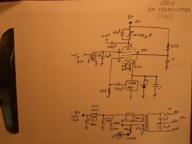

If by "kit" you would accept a parts list and schematic, you can build two highly regarded transmitters developed by members of this forum. A HUGE benefit is that you don't have to rely on getting assistance from one seller, as you have many forum members' experience with these as a resource.
TUBE- Norm Leal's 6888 transmitter viewtopic.php?p=495438
OR
SOLID STATE - Tom's (35Z5) LM386 transmitter viewtopic.php?f=12&t=193042

I'm interested in Norms transmitter. The link takes me to Mike Toon's thread, but non of the schematic links work. This thread is over 10 years old. Any help appreciated. I am reworking a mike osc. from 1953. I doubt it will have the best quality sound or range tho. Been studying a Heath diagram. The only thing that concerns me about building one is getting (or making) the right osc coil and tuning cap. I want a little more power than 10 or 20 ft, and good sound quality. I live in the country so a little too much grunt wont be a problem.

Here is Norm's original schematic for his 6888 transmitter.
Here's a poorer copy that includes a power supply.

Here's what I've found concerning transmitter hum.
It is best to have the transmitter grounded and add a switch to permit lifting the ground as some radios hum less with the ground conencted and others hum less with the ground lifted.
Proximity of the antenna to electrical wiring also plays a part in how much if any hum is present.
Also better control over the hum can be achieved by using a 1:1 audio transformer on the input keeping the input jack isolated from the transmitter ground.
For mine I installed an Edcor WSM15K/15K balanced/unbalanced to balanced/unbalanced transformer on my two tube transmitter and used an isolated 1/4" jack for the input. Reduced the hum level some and eliminated the effect the audio cable and device had on the hum level.
Yes, one benefit of Norm's 6888, aside from boost, is input isolation. :wink:
