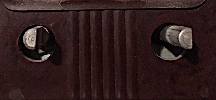

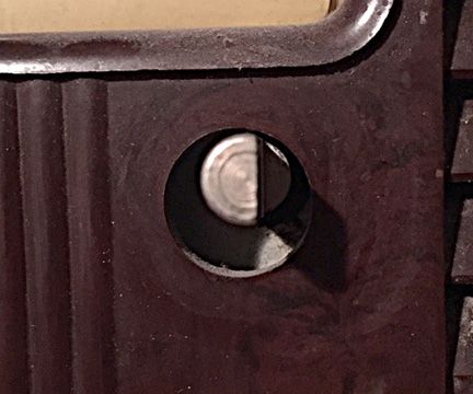

I took a look at the shafts and they might very well be 3/4. Here are a couple of pictures of them (it was more difficult that anticipated trying to take these):
What do you think?
Btw, it doesn't look like there was ever set screw knobs on these.

OK you have the half round shafts there, must be this radio was made for the 1942 model year. So the bullet knobs shown by Old Restorer will work great.
regards
Mark Oppat
