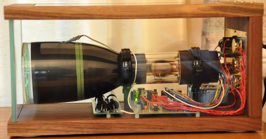

Your skills are admirable, and I can see the benefit of miniaturization, and when I was a kid learning to how to do stuff, I thought tubes (valves as I called them growing up in the UK) were a waste of time, and many hit the wall at high speed for fun! What have I done :oops:
In recent times I've found a lot of fun building and messing about with tubes, and their beauty, and of course superior audio.
My favorite project to date is this.
Just so much more fun to look at than SMCs :D
The casing took longer to make than the circuit...and that's 1/4" plate glass in front of the B+ of 2400 VDC :shock:

Nice scope clock !
Did you get it here ?
http://www.die-wuestens.de/dindex.htm?/r5.htm

I agree, nice scope clock. What's the CRT?

Awesome clock, Nodric! I have an old RCA WO-57A oscilloscope that looks like it's been hacked up a bit inside. Might be a good candidate for something like this since it would be a fair amount of work to restore to original.

Yes I did get the kit and tube from Jan. He's a very nice guy! I acquired all the parts before I left Europe for the States. I married a Citizen :)
The scope clock PCB and components comes from Bernhard Thiem http://www.thiem-work.de/ as he was the designer. Jan supplies the kit, but most importantly he supplies the CRT, and he also does the bespoke toroidal. The rest is over to you. I made the case, the brass control panel where I remote mounted the focus, stigmatism, and brightness, as well as other parts to connect power and set the time etc. I also fused each of the three secondaries on the tranny, as well as the primary (in the power lead socket). I added a big red illuminated switch just because I wanted one :-)
The time syncs to the mains 60hz, and will also work on 220 50hz. In Europe you can add a time signal board, but this is useless on the east coast as the time signal is in Colorado, and the clock can only work with a 1hr offset.

It's an AEG DN 10-14 CRT (super bright and about $100 NOS).
It needs post acceleration, with an anode voltage of +1500v and a cathode of -900v. The small extra PCB with the black caps on is the post acceleration that derives the extra oomph, and the rest of the tube feeds are fed off the main board. The deflection circuits are all on the board on trimmers. I was going to remote mount them as well, but it was proving hard to find multi turn trimmers that would mount on the rear.
The tube is not shielded (you wouldn't be able to see it otherwise :-) so it is sensitive to big chunks of metal and other sources of magnetism, so you have to locate it away from such things, and adjust defection in situ to get the optimal display.
