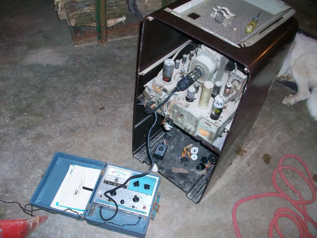

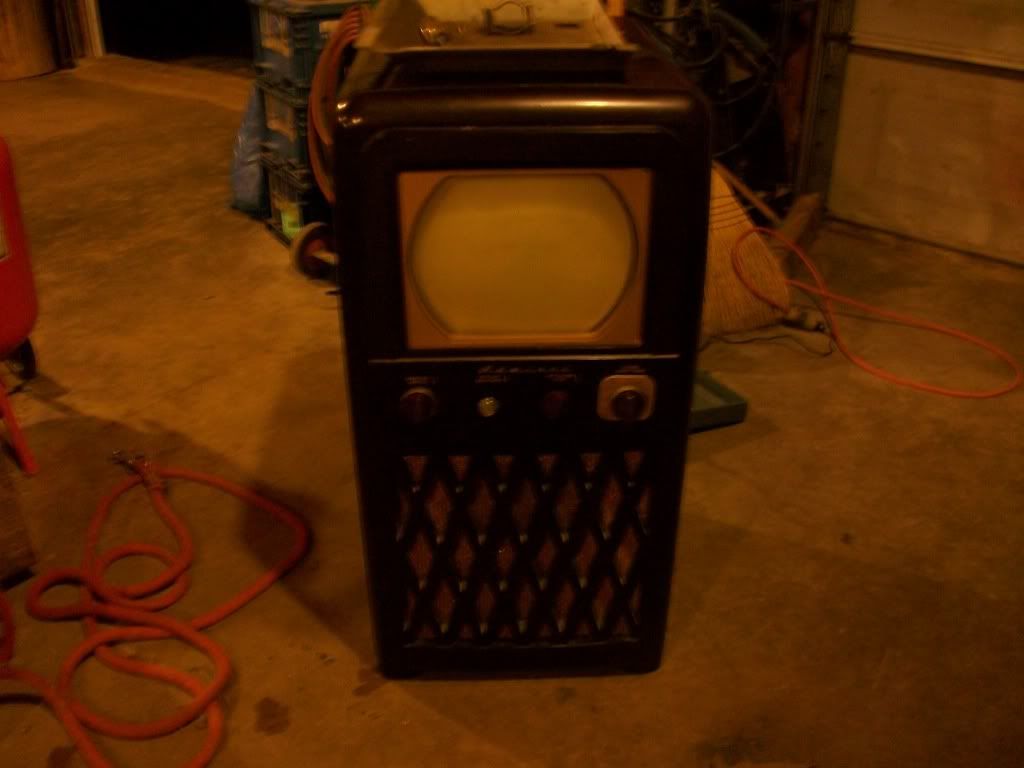

Hey guys, I picked this Admiral up today. I saw it on craigslist yesterday and went and picked it up today.
It's in good condition, a couple of knobs missing and the speaker is missing.
I'm letting the crt cook on my b&k tester to get the emissions up
I'm going to let it sit for a few more hours.

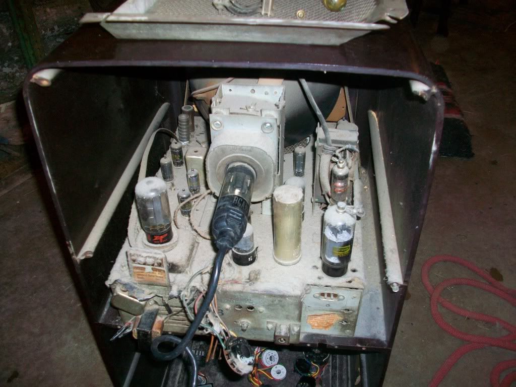

Oh I forgot to to say that the HV cage is missing too. But you can see that in the pics.

I can't quite see if there is a reading on the meter. So how does the CRT test?

Well guess what? Not only I need some knobs, HV cage, and a speaker. I also need a 10BP4 :cry: . It has horrable emissions. Something i didn't notice when I was looking at it before I bought it. It had homemade brightner put on. I didn't know what it was for at the begining or I would not bought the damn thing. Its the transformer on the back of the chassis in the 2nd pic down. Does anybody have some knobs, a HV cage, a speaker, and a good 10BP4 they want to sell?

These are really nice sets, so I would not be too worried about the bad CRT. Just go buy yourself some lousy TV with a 10BP4 in it (probably cost you $25) and liberate the CRT. Did you try rejuvination?

I tried it more than once. Running on about 9 volts, its bearly in the bad range and when its on 6.3 volts, its bearly off 0. When I tired the rejuvination it starts off bearly in the good range then it drops to almost 0. So she is shot.

Started digging around inside the chassis today. Seeing what resistors are out of tolerance. I removed that homemade brightner, cleaned off all the dust, testing the tubes. The chassis is not too bad of shape. There was not any rust, the dust really protected the chassis.
