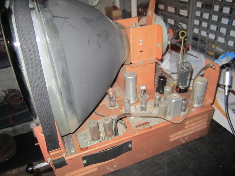

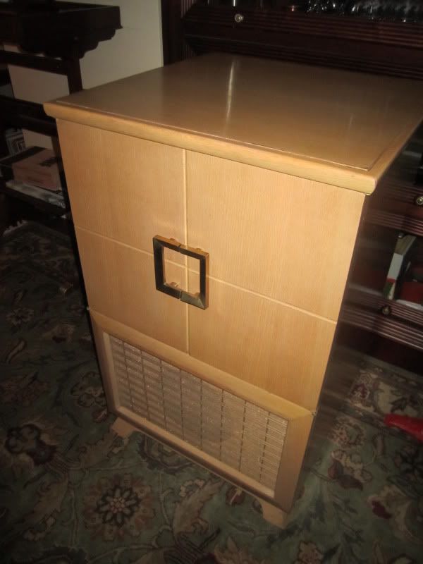

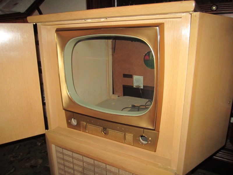

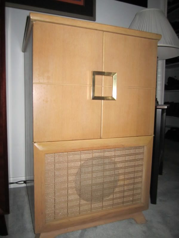

The Good News is it's in nice cosmetic condition - important, as blondes are high-maintinence.
It's also complete, and all the hardware, screen bezel, back, knobs, pencil box, etc are all nice. Chassis, a 21F1, is copper plated with a thin layer of dust. No corrosion anywhere.
The Bad News is the CRT, a 17BP4, is dead. I (barely) woke it up with a gun cleaning via a B&K 470, but the emissions is poor. So I need a CRT. 8)

I'm recapping the chassis, and it's up and running. Has some horizontal hold issues, etc.
Anybody have a Chassis Maunal for this Admiral? It's stamped 21F1. I don't have it.
Thanks In Advance 8)

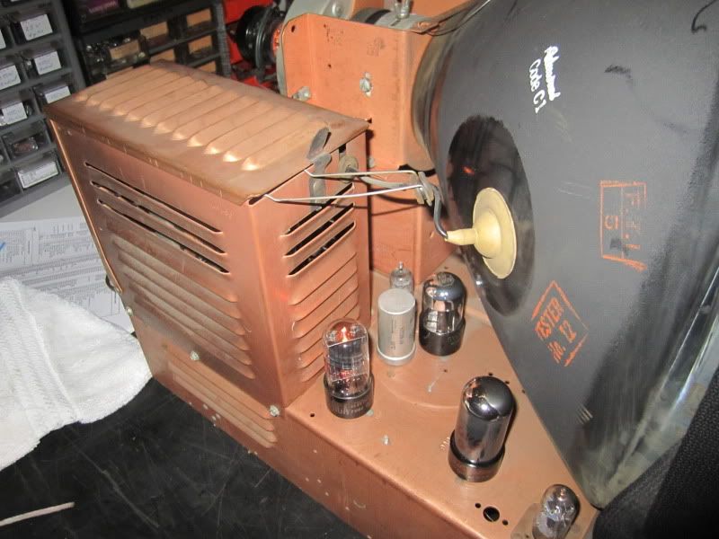

Did a recap (tubulars and a couple of electrolytics) and replaced the 12AU7 Synch Seperator & Clipper and presto, a nice stable pic.
I have a problem with the Focus Control having a burn spot where peak focus is located. I'm wondering whether reversing the poles would relocate peak focus to another spot on the wire wound control.
That was easy. Once again, an early Admiral has bounced back without any undue drama. Hell, the thing almost worked when it came thru the door. If I replaced the 12AU7 alone it would have worked. All the tubes that came with the set seem to work just fine.

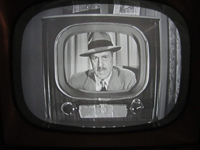

I swapped outer poles on the Focus Control. and now the TV is performing - beautifully. Nice and sharp. Sounds good, too.
I can't understand why this CRT looks sooo good. It tests weak (high in the red zone) yet looks fine. I can only imagine what it would look like with a good CRT. 8)

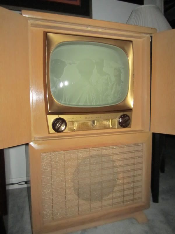

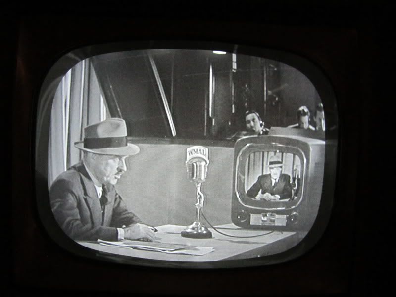

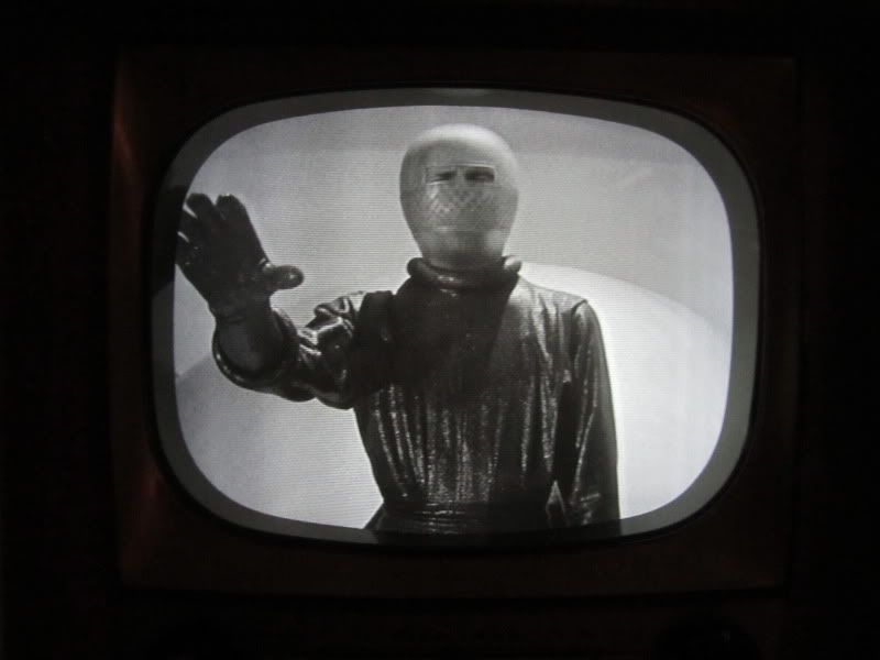

Here she is...up and running.
Chassis is very clean.
Cabinet cosmetics are exceptional.
All I have to do now is assemble it into the cabinet. It's pretty much done. I might swap out the CRT if I come up with one. 8)
Lee
Worcester, Mass

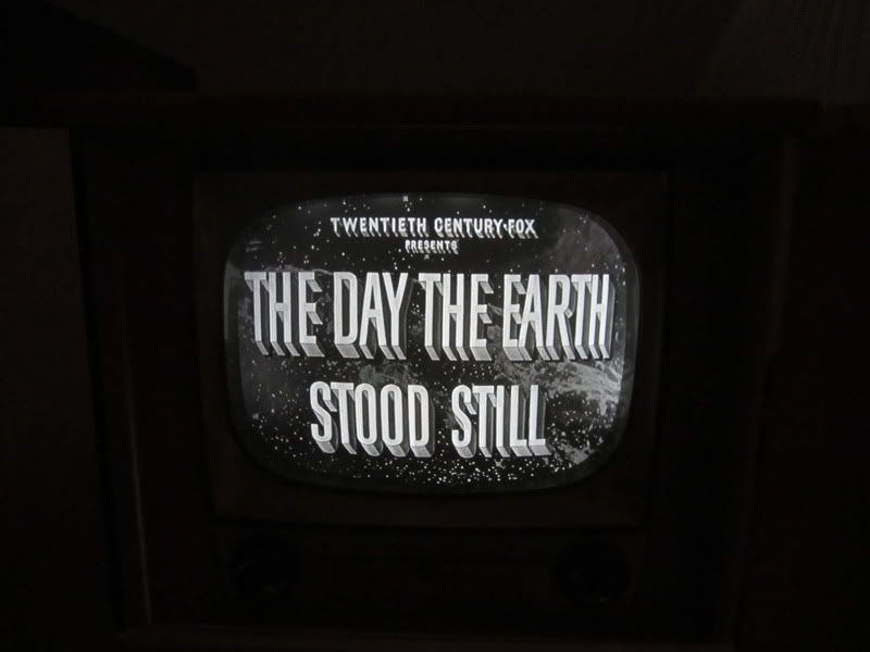

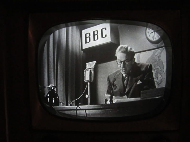

This is the latest TV Set I have restored. According to an inspection stamp, it was mfd June 26, 1951.
It was, by far, the easiest TV I have ever restored. It's amazing, in two or three short years, how advanced Television receivers became. This Admiral is easy to understand, fix, and troubleshoot. The circuitry is quite simple, compared to TVs from 1946 through 1949. It's also a stellar performer, even with a marginal CRT. So much for Mad Man Muntz...
It didn't take much. I replaced all the tubulars, one of the axial electrolytics (in the IF section), swapped out about 6 tubes, and tweaked front and back controls to achieve peak performance.
I didn't replace the canned electrolytics. Maybe I'm getting lazy, but they are running cool as cucumbers, so I'm leaving them be. Think I should?

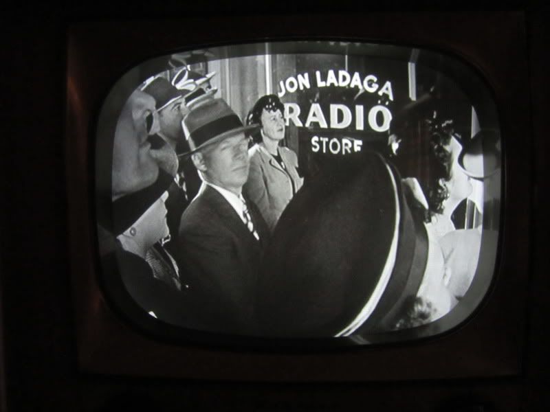

The first feature-length film I played was, of course, "The Day The Earth Stood Still" from 1951.

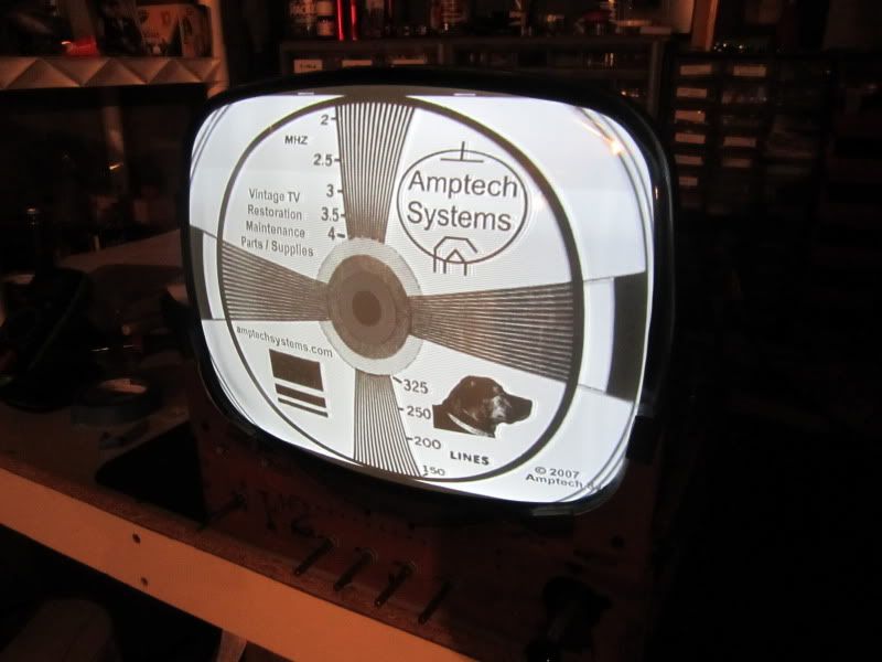

Maybe this guy can resusitate my 17BP4...

I have Admirals of around that vintage still running fine on the original electrolytics. But I don't use them a lot. One of my friends is running a 12" with all the original electrolytics still in it and uses it several times a week.
If they run cool and you continue to monitor can temperature (and maybe line wattage as well) they could run for quite a while yet. On the other hand, it bothers me to know those parts are over 60 years old and if I were using it a lot, then I would be inclined to replace the electrolytics now with new Nichicons mounted under the chassis on terminal strips, since there's probably only $12 or $15 worth of them in the set.
Strange, because you probably won't find an RCA (or most other brands) where the electrolytics weren't bad a long time ago. I haven't seen many in the past 20 years or so that passed the test or ran cool to the touch. And the same handful of vendors built all of the electrolytics for most of the manufacturers. You would reasonably expect all of them to be just as bad.
 Post subject: Re: My First Blonde...Admiral 27K27B 17" TV
PostPosted: May Tue 01, 2012 11:09 pm
Posts: 2066
Location: Orlando
Wow that picture looks great. I would be inclined to leave the caps be, if they are working well and not overheating. Perhaps install a B+ fuse ahead of the caps, that way if they ever did short, the fuse would blow sooner than just the regular power transformer circuit breaker or fuse if it has one. I too am suprised those caps are still good, Most of my mid 60's era caps test good but not early 50's.

Very nice! That picture is about as sharp as it could be.
PostPosted: May Tue 01, 2012 11:27 pm
Posts: 2173
Location: Worcester, Mass.
There is a fuse in the HV Cage. I assume that's enough to protect the set. Or, is it...?
I ran it for three hours straight. The Canned 'Lytics got only slightly warm to the touch. I'm only going to run the TV for an hour or so a few times a week. I'll monitor it from time to time.
