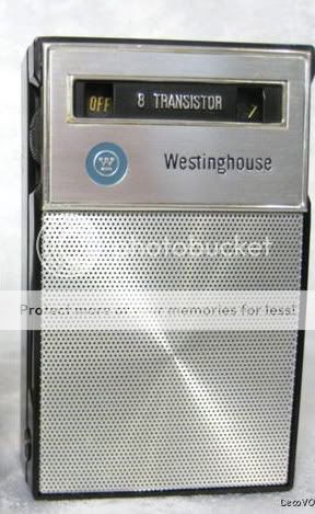

I have a Westinghouse model H-914P8GPC that I have used daily for years. It's been my "shaving radio" and source of news on WBZ Boston. It is a shirt pocket sized 8 transistor model and was a good performer. Up until last Tuesday that is.
It has lost nearly all its great sensitivity but remains loud and clear on just one nearby AM station. It has not been dropped. I have its twin, not tested as it has a bad battery clip and broken switch (does not shut off) that set could be a source of a needed part if a hard to get part should be needed.

Either the oscillator stopped working, or more likely an antenna lead got D/C from the tuner or board.
Test the oscillator function by placing the working set next to it, turned on and tuned to 1000 Kilocycles, and rotate the tuner to see if you can get a squeal from the working set, 455 Kc above or below.
If so, and if you are able, take the radio out of it's case and inspect the three or four wires coming off the antenna Ferrite coil.

Thank you for your reply, fifties. The oscillator is working, the local station is 1420 and that's where it may be tuned on the dial. It's just that the previously good sensitivity is now very poor.
Between my limited eyesight and impaired motor skills, taking the pc board out of the cabinet is not something I can do anymore. I was hoping to find someone to repair this radio for me.
Broken wires are not likely, as the problem arose during completely normal use.

 Post subject: Re: Help Needed
PostPosted: Jun Tue 21, 2011 11:31 pm
Joined: Oct Fri 02, 2009 7:05 pm
Posts: 1119
Location: Wolfeboro, NH
Here's a shot of Ed's future project.
It was, until lately, a great performing little radio.

Hi Mal and the group,
I received the radios today and had a brief inspection. They are the GP and GPC models made in different plants, so there are differences between them.
The working set seems fine on the upper end but quiet below that. Works great picking up my SStrans at 1530, but it's only 10 feet away. However, it can tune out interference from my computer monitor, which many other radios have a problem with.
The non-working set has a resistor laid on top of one of the transformers. This seems to have been shorted or had a battery reaction, as the resistor is damaged and I can see bare wires from the transformer at the contact point. That will be my first point of attack in repairing that set once I install a new battery connector.
