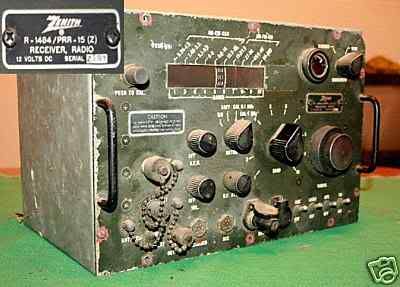

Made by Zenith. May also be known as AN/PRR-15. Was possibly used for intelligence gathering by USMC? Repeated searches produce precious little info.
Looking for manual, schematic, any info I can find.
Got it pretty cheap on ePay, now need info...

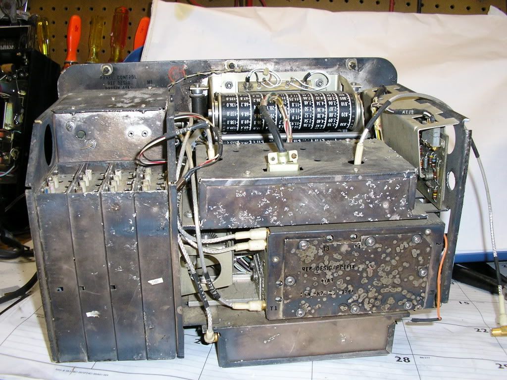

Frequency Readout is Mechanical, like on a Tube Tester:
No clue how to power it up...

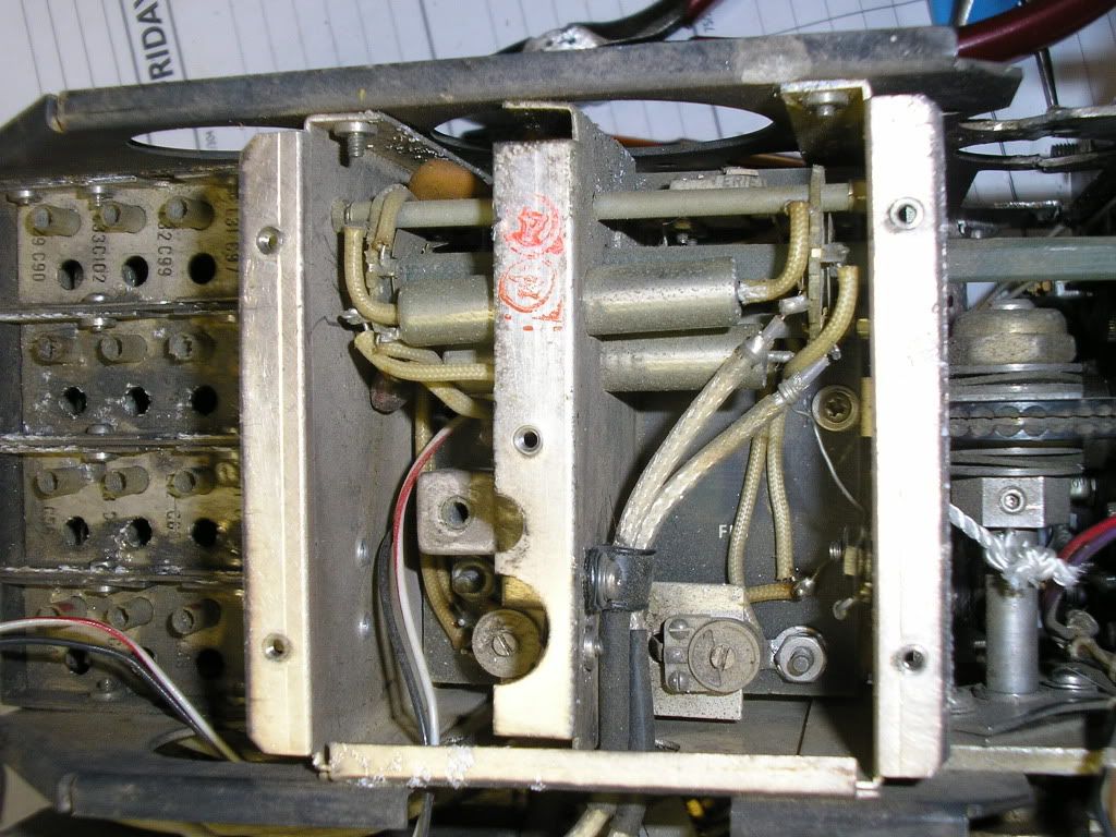

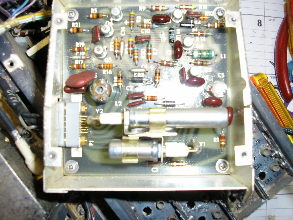

Is this two mechanical Filters? Inside a module with selector switch for "Wide" and "Narrow".
Wonder if it's 455 Kc?
Xtals in Xtal Calibrator?
"Hot" leads going to On Off Switch are Red and Red/White. Black leads are connected to chassis. I know It takes 12 Volts DC. Can I assume it's Negative Ground? Can I assume anything???

PostPosted: Oct Sun 04, 2009 7:30 pm
Posts: 8461
First, see what types of transistors it takes; NPN or PNP. If they are PNP, the positive terminal of the battery will feed the emitter circuits.
If they are NPN, the positive will feed the collector circuits.
You'll have to do a little circuit tracing.
Nice find; there can't be too many of those around.

PostPosted: Oct Tue 06, 2009 11:40 pm
Posts: 4962
Location: La Porte, IN, USA
Powered it up this evening. Hooked up the B+ from a variable voltage regulated supply to the red wire on power switch. Hooked up 200 Ohm phones to the phone jack and got a nice rushing sound from the Audio amp. accidentally found a line level audio wire (broken off from a multi-conductor plug) and when touched it gives a nice loud hum.. Audio amp works O.K. Hooray!!
Tried injecting 455 Kc from a signal generator various different places (inputs to modules that look like they may be IF). No response. Tried varying this frequency. Still no response. Several discoed wires still hanging loose and unidentified.
This is really a challenge, with no schematic or knowledge of the circuit. Everything is in little module tin boxes, hooked together with plugs and jacks. Nothing labelled as to function.
It's going to be mighty slow going with no manual or schematic.
Quite a challenge.
