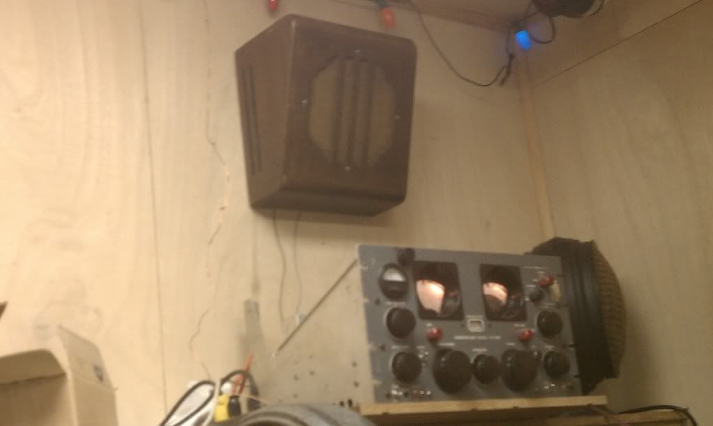

I looked at the SP-600 and found where I had replaced the two audio coupling caps with a couple electrolytic caps some time in the past. I went ahead and replaced them with a couple .1 uF film caps.
Listening to the internet feed of WRDV broadcast to it through my two tube broadcaster as I type. I had forgotten just how good the audio sounds through the wall mount jukebox speaker with original 10" Rola speaker installed. The Hammond 600/4-8 ohm transformer is mounted in the wood speaker box as well.
My plan is to have a similar looking box built for the 15" Jensen used with my R-390 and then mounting it and setting the R-390 to the right of the SP-600.
Like I've posted before those old jukebox speakers make the best speakers for communications receivers.

I've always loved how good the audio sounds from the Hammarlund. With my current speaker I can fill my 12' X 12' building full of sound.
