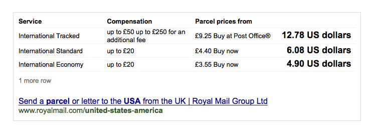

The six dollar standard shipping is 5 to 7 (business) days.
Economy at a fiver is sea-mail, and could take up to 6 weeks!
I am more than happy to pay ICOM for it/them and ship to you.
oh... send me your email address via PM (private message).
