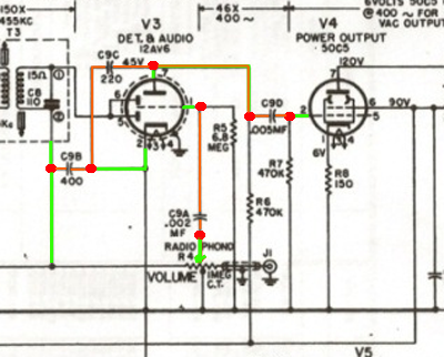

Capacitors C9A-D are contained in a couplate.

C9-D (.005uf) is usually one of the first to go bad... and needs to be replaced.
So remove those pins on the couplet and replace just THAT cap.. or go ahead and remove the entire couplet and replace each cap & resistor in it with individual discrete units.

Hi again:
I'll try to lay it out real simply.
Just connect to the RED dots...
locate the pins on the tubes as marked and solder there.
One of the wires coming out of the IF can goes to one end of C9B and the other end of C9B goes to pin-2 of V3
Also one end of C9-C goes to pin-2 of V3
The other end of C9-C goes to pin 7 of V3.
One end of R6 goes to V3-pin-7
Also ...One end of C9D goes to V3 pin-7 and the other end of C9D goes to pin-2 of V4
One end of R7 also goes to pin-2 of V4
One end of C9A goes from the CT of the vol control and the other end goes to pin-1 of V3
one end of R-5 also goes to pin-1 of V-3
It can't be much simpler than that.
Follow those red-dot connection points.
