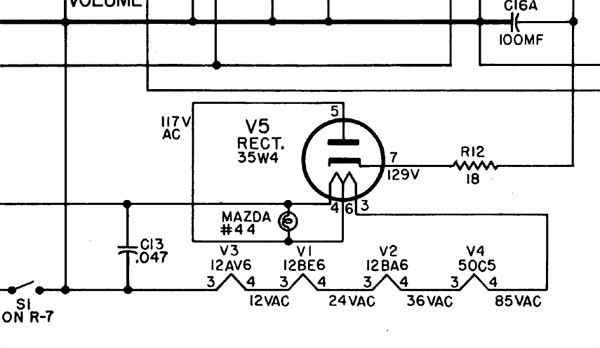

Apparently I spoke too soon: when I returned home this evening I turned on the radio (cold) at full 110 volts. The lamp went super bright and burned out in about 2 seconds. I shut it off immediately but not quick enough. Another 35W4 rectifier bit the dust. I replaced it with my last and fourth good 35W4 tube. If I start the radio at 60 volts and gradually increase to 110 it works ok, but now the lamp is extremely dim, just an orange glow on the filament.
There is some kind of surge problem burning out these rectifiers. I don't think it is from anything I've done. I've checked and rechecked all the connections on my replacement caps and they are all correct.
There are two anomalies probably worth mentioning, but I don't know if they are important. I replaced a .047uF bumblebee cap across the AC lines with a .1uF safety cap. Could that be causing the problem? I don't have any .047uF or ,05uF safety caps on hand. Secondly, there is a .02uF cap that I replaced between the center volume lug and pin 1 of the 12AV6 detector. Just incidentally I had run out of .02uF caps so I connected two .01uF caps in parallel. But that's neither here nor there. The thing that i just noticed is that the markings on these two caps, (the black ink that shows the uF and voltage) are completely gone - like erased - from one of the caps and mostly gone from the other! These caps were fine when I installed them..... What caused the ink markings to disappear? Could they be getting very hot or something?

Hi John
That (c-13) 0.1uf @630vdc cap across the AC line is probably not a problem but if you place another 0.1uf cap in series with it across the line you will have a combined cap = 0.05uf @1260v. That will be safer.
Are you using a #44 lamp or a #47 lamp?
The print calls for #44 lamp which can carry 250ma whereas the #47 can only carry 150ma.
To help you troubleshoot and not blow more 35w4 tubes ... you can probably use one of the already blown tubes for testing purposes by temp connecting an alligator lead across pins 4 and 6.
Remove the bulb.
This will by-pass or jumper across the "open" section of the filament and the tube should still operate alright.
In this configuration you will be able to take some test readings with the Variac at 120volts AC.
Put your multimeter in DC ma mode and connect it in SERIES with the RED wire going to the output transformer.
You should read around 60ma if the radio has a normal B+ load.
Measure the plate of the 50C5 for 120vDC and the cathode for 6vDC.
The screen grid pin 6 should read about 90vdc.
MAKE sure you have the polarities on the two electrolytic caps C-16-A and C16-B connected properly.
If your B+ current exceeds 60ma by any real significant amount, then there is something shorting in the B+ circuit.
There could be something like a short in the output transformer or elsewhere.
SUGGESTION:
==>>To avoid blowing out more 35W4 tubes while you do your troubleshooting, ....Another thing you can do is to remove the 35W4 tube completely and without the #44 bulb either.
Then use TWO 1N4007 diodes to take its place.
1.) Connect one diode as shown across pins 4 and 3. That will provide about 84volts of pulsating DC to properly operate the balance of the filament string when the 35W4 tube is no longer there.
2.) Connect another diode across pins 4 and 7 in the direction shown below. This diode will replace the rectifier action of the 35W4 completely.
In this mode you'll have a properly functioning rectifier for DC (although B+ will be a bit higher)
.... and your filament string balance will operate as well.
This substitute device can be made easily and inserted from the top of the socket.
Just solder the two anode ends of the diodes together to form a "Y"
....so you'll have only one common anode lead to insert into pin 4 from the top side of the socket.
Then you can insert the cathode end of one diode into pin 3 and the other cathode end into pin 7
At this point again you should be able to do all your testing and troubleshooting until you get the radio to a stable condition.
After troubleshooting and once everything is operating properly... you can remove the two diodes and reinsert the 35W4 and #44 lamp.

Peter, you are an absolute genious! Crossing the 4 and 6 pin of a dead rectifier will save me from burning out any more of them! I don't know how to thank you for all this advice. I'll just be extra careful and make sure that I don't start it at full voltage while those pins are jumped. I'm busy most of today helping a friend with her car problems, but I'm itching to get home and perform these tests.
I want to mention this again because I agree with your suspicion there is a B+ short. When I turn the voltage up over 110 volts I get intermittent crashing/clicking sounds and significant loss of signal, pretty much just like before, although the signal is still a tiny bit audible. As a novice I'm still suspecting SMD and that the short is in the IF coils. While running the unit at around 65 or 70 volts I'm getting B+ voltage on the primary side of each coil at about 29 or 30 volts. The secondary side of each coil is showing very low negative voltage, like around -.25 to -.6. As I increase the voltage to around 110 the secondary coil voltage jumps up to around -3 or -4 volts. Is that normal? Since the output of the coil is going to the grid of the following tube I think it's supposed to be negative, right? I'm pretty certain that before I replaced the 12BA6 tube I was getting positive voltages on the secondary coils, when the ONLY thing that could be heard was crashing/clicking sounds.
Anyway I'm going to follow your protocol of tests as soon as I return. I've looked your thoughts over and think you are absolutely right. Somewhere in those tests we're going to find the answer.
Ex_Prof: Hang in there... We've made a lot of headway so far on the 447 and it's apparent that whatever went awry with it caused several components to go bad or out of tolerance. So far I've been able to treat the "symptoms" one by one until we have a working, testable radio at about 60 or 70 volts, but haven't yet found the root cause. But it looks like we're getting really close to a "cure!"

Shorting between pin #4 and #6 will get the filaments operating again. If no no other problems B+ will be present.
There is one disadvantage. This section of filaments acts as a fuse. If something shorts it blows. Without it, no fuse.
A lamp in series with the AC line would be a good idea. It will light bright if something shorts.
Norm

If you didn't scroll down enough you may have missed the second section of my post above:
I'll repeat it here:
SUGGESTION:
This (two-diode) substitute device can be made easily and inserted from the top of the socket.
