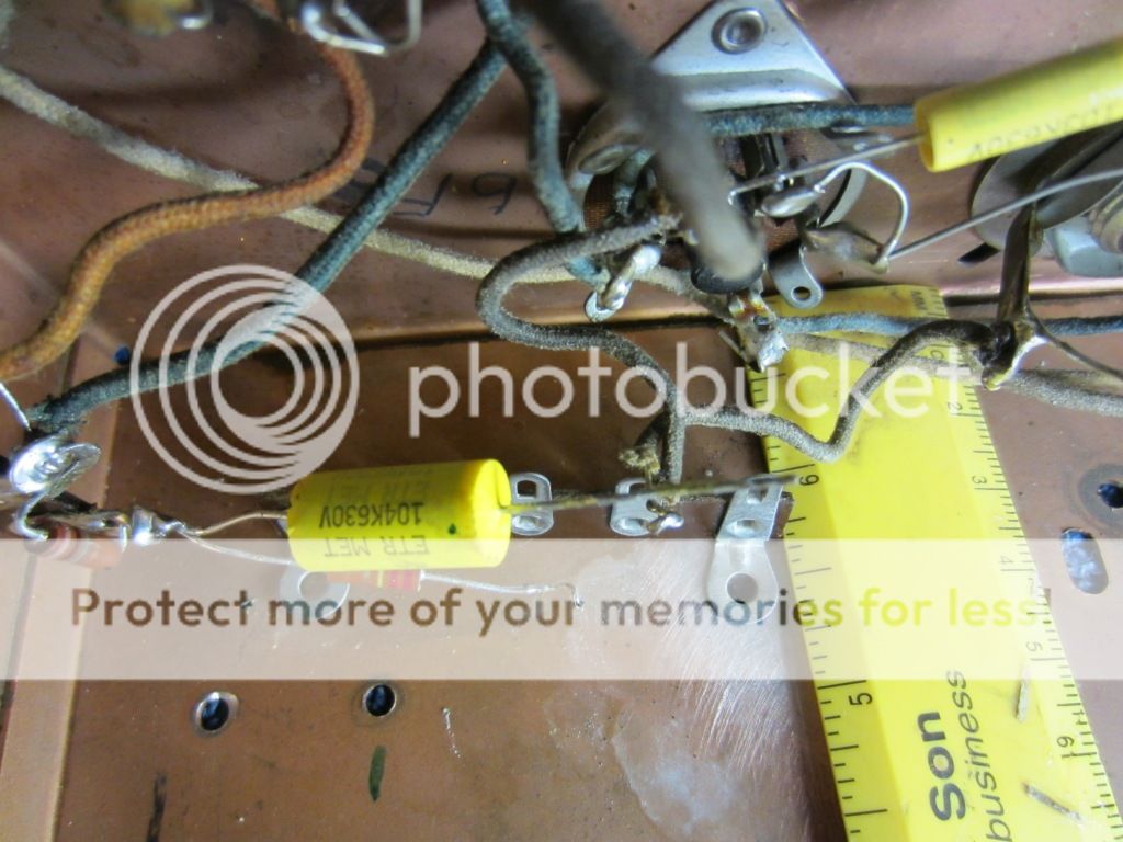

I'm replacing the candohm in my Zenith. This is the last part that needs to go. I refuse to extend the leads, especially the leads of components already in soldered in on one end. I'm not very good at it and only extend them as a last resort.

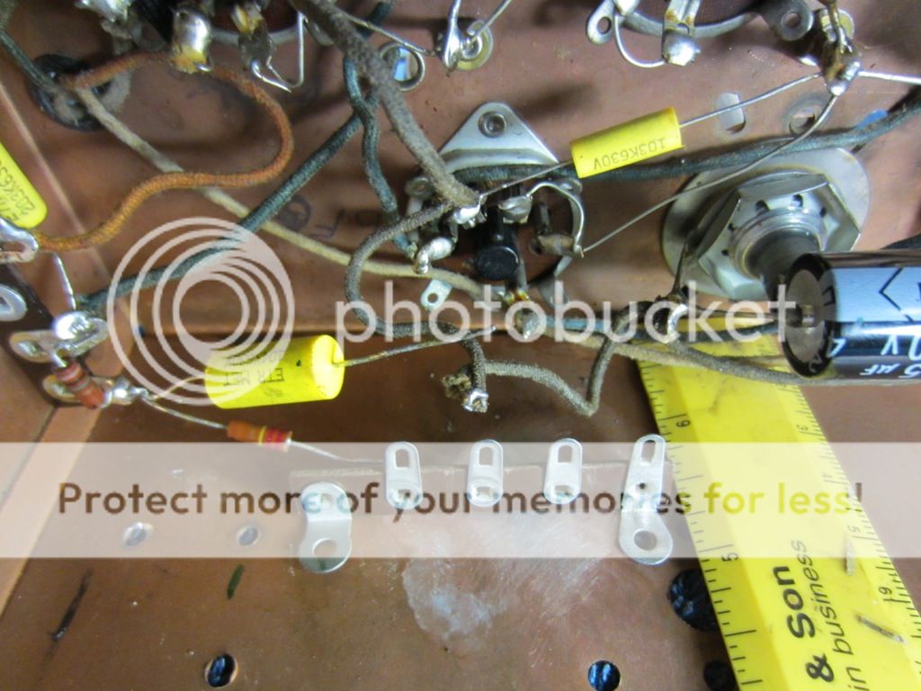

The first picture is of where I'd like to shift the candohm, the leads will make it/wires will stretch a bit to get there. The second picture is where the candohm originally was.
I have to move two wires just a little bit that go to the candohm, and overall the whole set up will be about 1/2 to an inch closer the 6F5G tube socket.
Am I going to introduce any hum or problems relocating it there??
The difference is somewhat slight, but if I'm going to solder everything back on, I don't want to have to relocate it again.

You'll be okay with the location shown. Stand the new resistors up to where they get good air flow. Tube socket won't be bothered.
