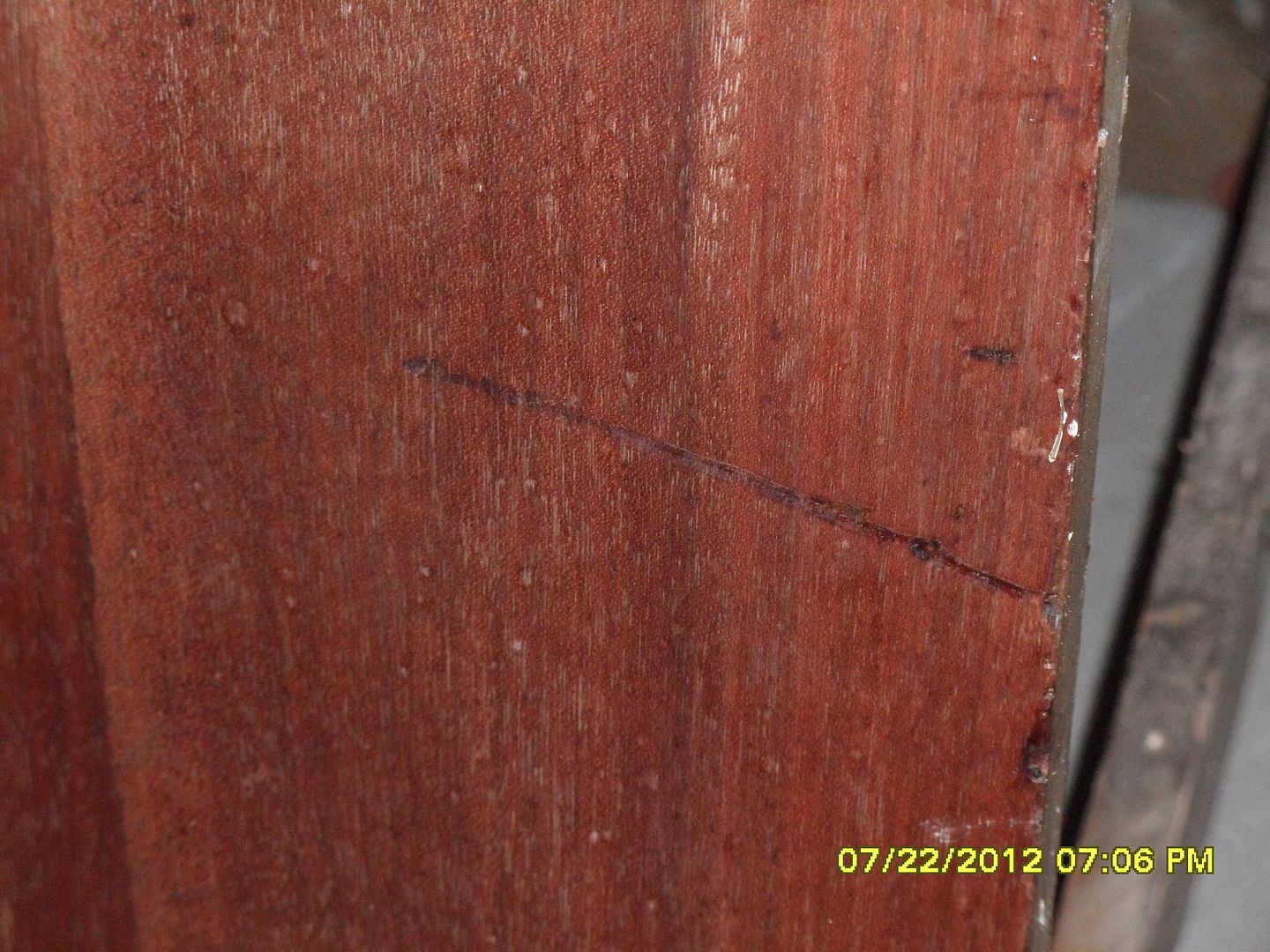

I did a little veneer repair work today, after church and the beach. It is amazing that this cabinet had just one tiny missing chip (1/8" square, or less) on a back corner of the top. However, it has a scratch on the lower part of one side. A veneer patch would probably look worse than just filling it, and using some oil paint crayons to try to add some vertical "grain."

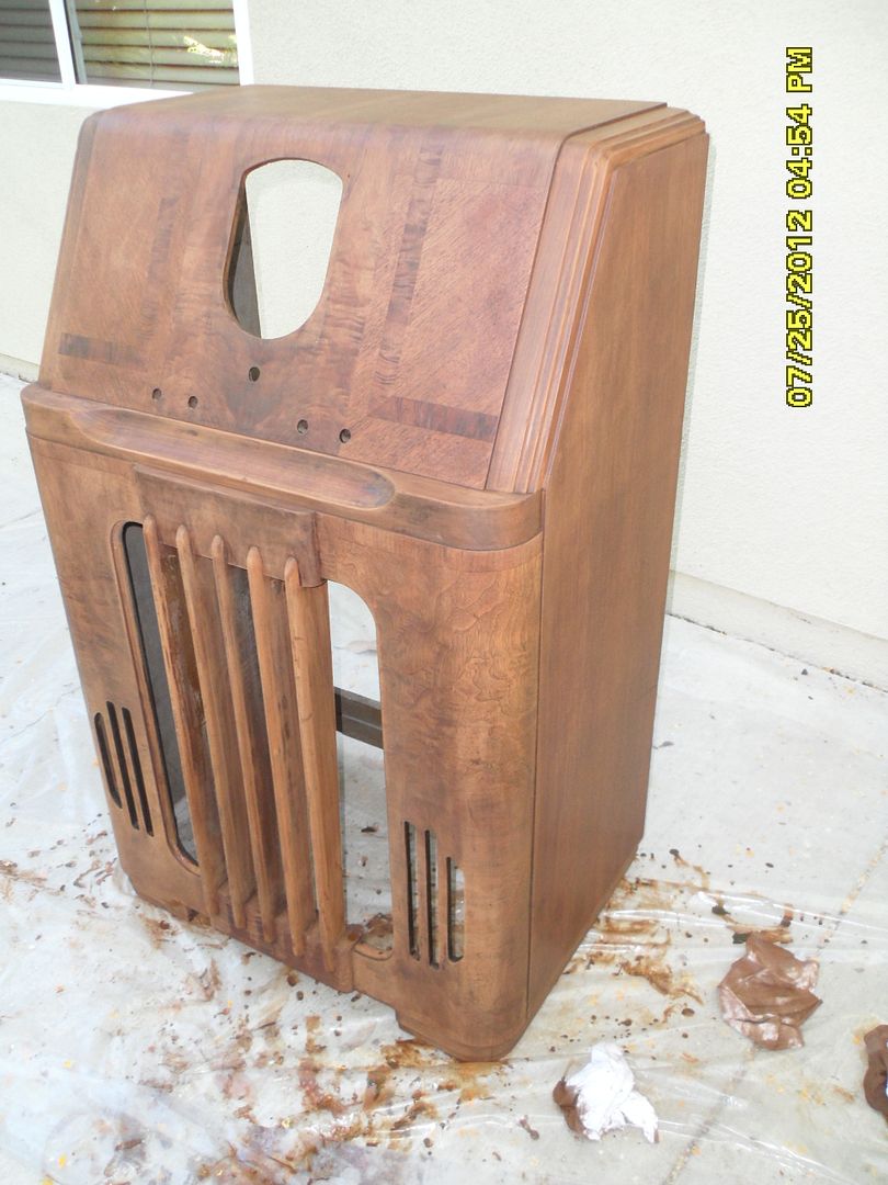

Here it is after:
1) Lightly sanding the cabinet
2) Using lacquer thinner and acetone to remove remnants of lacquer
3) Reapair of anotehr small veneer chip on the back edge of one side
4) Applying "nutmeg" water-based stain

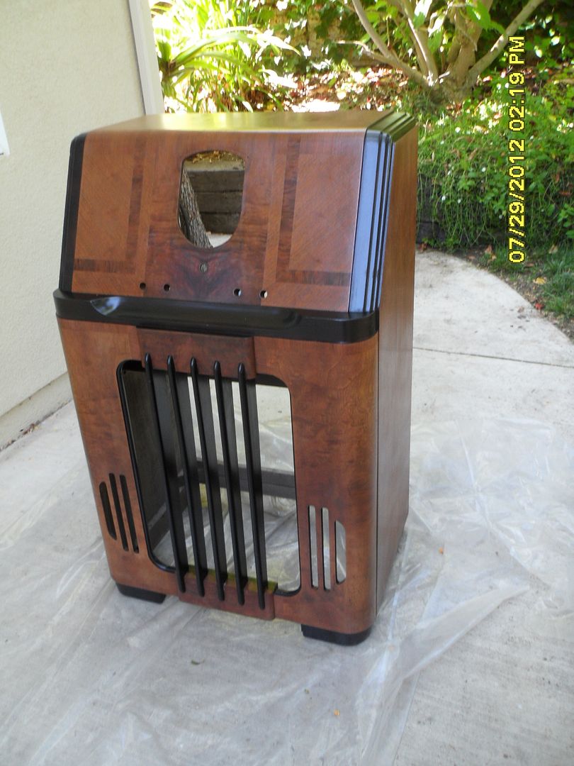

It is a good idea to wear gloves and have a tweezer handy when spraying lacquer outdoors, to be able to get rid of dust, bugs which get in it when it is wet. Of course, a good-fitting respirator with the proper cartridges is needed. I also keep a can of blush/retarder and blender/flow-out handy, and newer do more than mist vertical surfaces, instead movingt he item to spray surfaces which are horizontal.
We had too much going-on Sunday moring, after working almost a double day Saturday, so I forgot to apply any grain filler. Fortunately, it is a tight-grained veneer, and much of the old filler is still present. I'll just have to use more lacquer to get it smooth.
Before spraying any toned lacquer on the trim, the entire radio should be sprayed with clear lacquer. That makes it easier to apply and remove the masking tape, lessening the risk of damaging veneer whern the tape is pulled off. After the clear dried, I applyed the masking. I managed to grab on grill bar and break it, so I had to glue it and reinstall it.
Here it is with the first coat of clear and the trim coated with a few coats of Dark Van Dyke Brown:

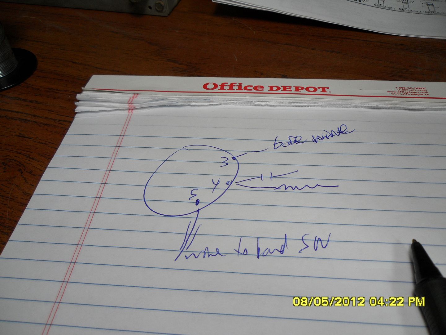

Time for the chassis work. I had removed the sub-chassis and tagged the cut wires with blue tape with numbers & letters.
Two capacitors changed, now needed to disconnect one end of a resistor to test it, but other wires / parts were in the way, so I made a sketch in case I was interruped
Now it can be tested and found to be bad. We all really need to stop using the term "recapped" as testing and replacing resistors is also an important part of the work.

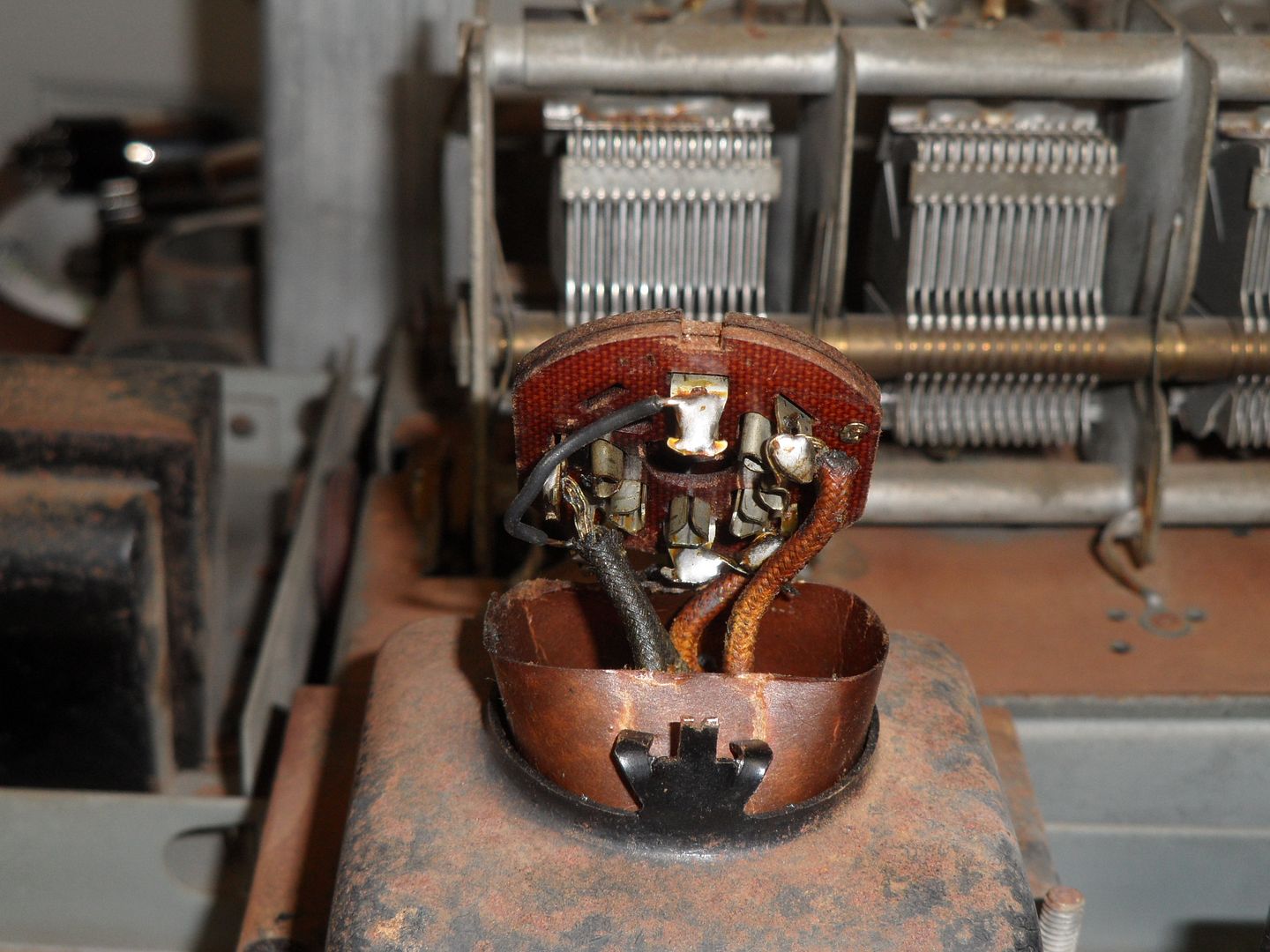

It played for the first time today! Better still, with no adjustments, it received many stations loud and clear.
Playing for the first time (transformer cover outdoors for repainting)
Somebody had rewired the rectifier socket for something other than a 5X4G! That could be a real gotcha, so I'd suggest checking your radios.

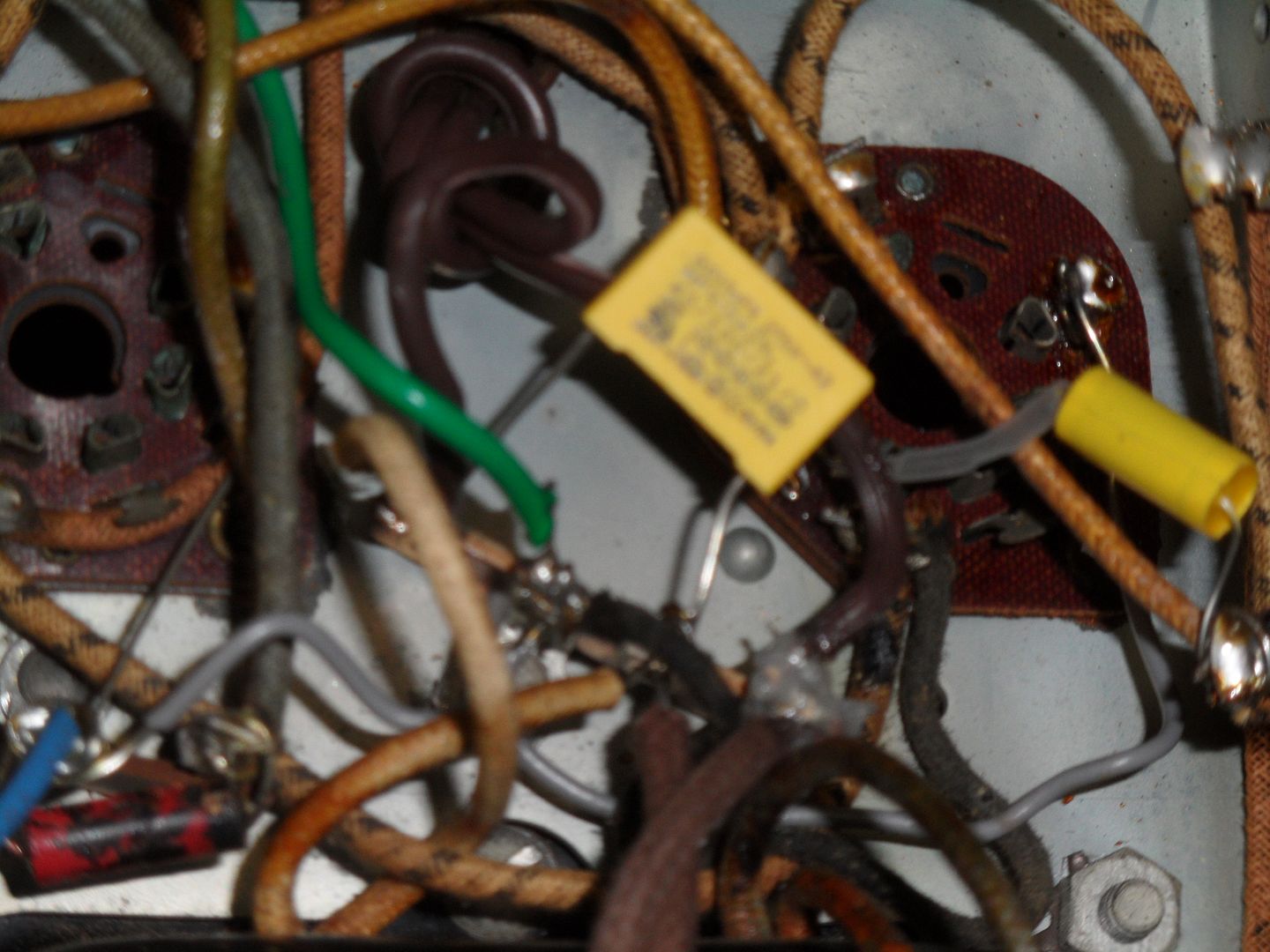

Chassis bottom finished (almost - I still need to get the AUX input working)
I tied rivet and screw grounds together in several groups, as I've read here several times of wierd problems caused by bad rivet grounds
I added a fuse
I added a CL-90 and used nice hole plugs on the old capacitor holes
I used a capacitor across the line (after the switch), instead of the original two from each side of the line to the chassis dumping 120V on the chassis
I replaced the three tuning subchassis mounts, back gang capacitor grommet, and chassis front grommets with the nice reproductions from Rennovated Radios
