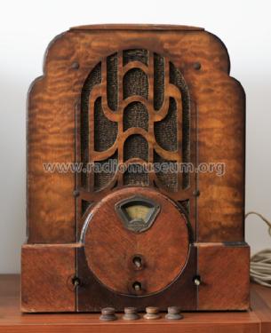

The only example I can find is on Radio Museum and somehow that looks like maybe it was refinished.
What say you?
Ed

It is time to pick out a speaker fabric but with my eyesight it is difficult to match it up with what I can find on line. Are there some common styles that Stewart Warner used for this line of radios?
Here is the best picture of the cloth that I can find.
Ed

Out of seven Stewart Warner radios from 1933 model year I have only Troubador had generic golden cloth with some pattern, but this might might have been a replacement.
All the rest have this black with some gold cloth similar to the one in your picture. Difficult indeed to find a similar one...

Hello ED, the closest I could find with some pattern and color and thick weave is this zenith pattern I had at my shop , the color is there with the heavy thick weave, look somewhat similar in pattern as the picture of yours. Here's mine with new cloth and the old original cloth I took out

This fabric Ed is as close as I could find as I had some at the shop, its old fabric from the suppler that went out of business few years back. Looks like zenith pattern as yours does but the color is there and the thick weave. Not bad if you as me, don't think you will find a exact match. I think the original pattern for this 1271 and others had a diamond pattern with the gold and some copper and black. Heres mine with the new cloth and a picture of the cloth that came out (original cloth).
