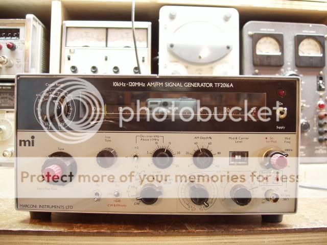

My little pea brain immediately thinks of a Marconi TF-2016A which spanks both the HP and URMD25, considering it weighs less/smaller, solid state circuitry, AM/FM, 10khz-120mhz, has counter output, good stability.

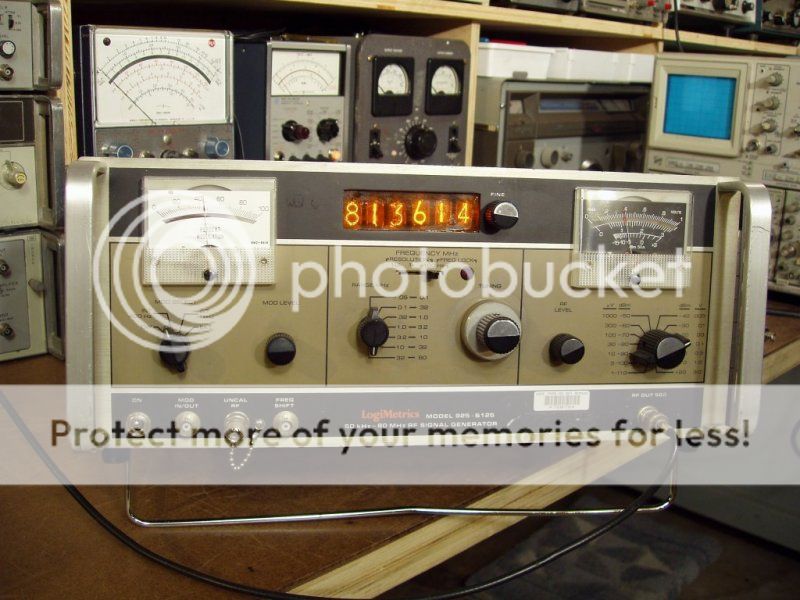

My next thought leads me to two other spankers: Logimetrics 921A/925 & SG-1144U solid state units (has a nixie display for the tube junkies to get their "fix"), 10khz-80mhz, freq. lock, stable to 100hz, separate meters for AM-mod. & RF atten.

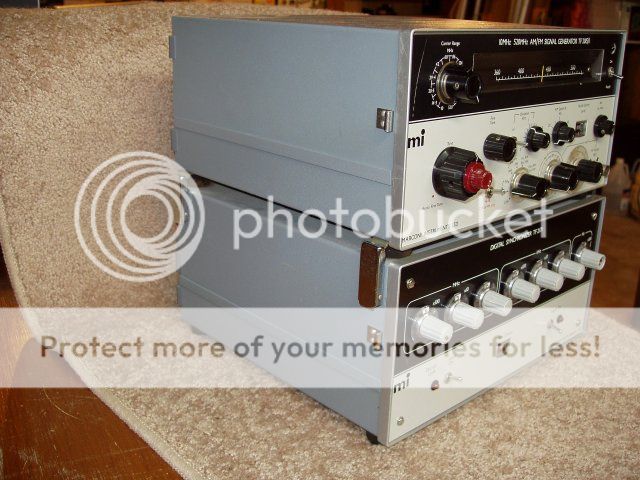

The Marconi's are fairly rare, and you could get mitey gray waiting for one to show up. An interesting design, but fairly leaky, and constantly drifts, although the rate does slow down after an hour or so. That aside, it is an AM/FM, and composite signal generator, with very good frequency coverage.
This VHF version is just about useless with out the separate frequency lock box.
This generator should get an award for one of the worst generators ever. It does have frequency lock, but if you find one its usually WAY over priced for what it is.
I've had all three, bought them as not running/parts units, repaired, verified performance per the manuals, and got rid of them, especially the Dogimetrics, as soon as as possible.
