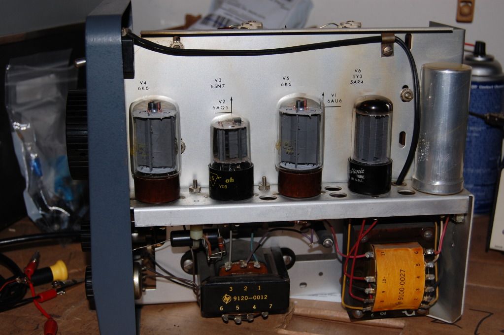

I have an HP 200AB serial number 606-20937 that I picked up for a good price. Comparing it to the service manual and schematic I found on line for units with serial numbers 7725 and above I see that mine must be a later model since the tube line up is different. Mine uses a 6AU6 rather than 6SJ7 and a 6AQ5 rather than 6K6 in the audio oscillator circuit. The rest of thte tubes are the same. I think there are also differences in the filtering caps from that in thte manual.
My unit is in terrific cosmetic shape, clean and untouched. Does anyone by chance have a correct schematic for my later unit? I've been unable to locate one that matches my unit. Also, how long did HP manufacture these units? I see a QC inspection sticker inside dated 9-'97. That can't be the date of original manufacture could it? Also there was a test equipment inspection tag dated Feb 2003 indicating a problem with power supply filter caps. I plan on re-capping the electrolytics and paper caps as a start. I have not as yet powered it up but previous owner indicated it did work but had a ripple on the output.

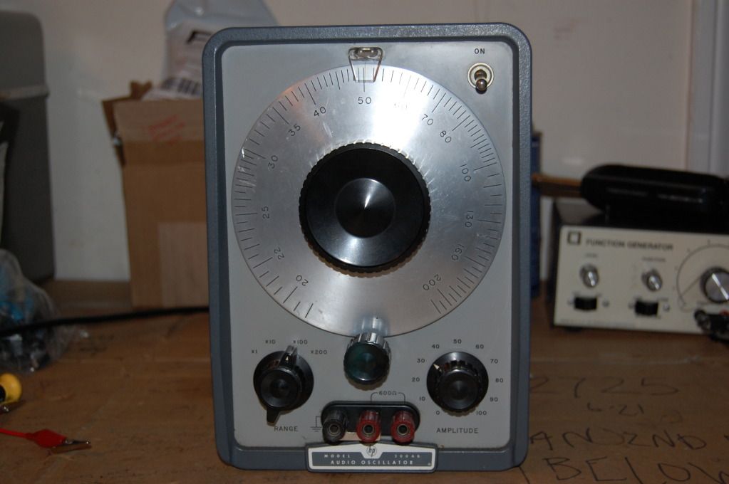

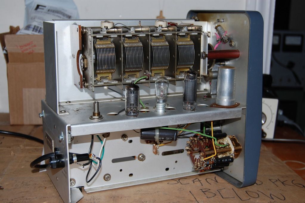

Here are a few pictures for those interested. I'm impressed with the build quality and the feel of the switches and the movement of the dial. It's a beautiful peice.

The HP manual archive site has two manuals but both are for the 6K6 - 6SJ7. However, the one manual has some user-added markings on the schematic indicating the 6AQ5 and 6AU6 with a couple of notations for other differences. Electrically, there's not a whole lot of difference between the octal tubes and the 7 pin miniature replacements in the 200AB circuit. The 200AB is a real keeper. and can be used as an audio amp of obviously very wide frequency range with that serious inverse feedback output transformer.

Thanks for the link to the updated schematic, that will help! I took a look at the 6K6 tubes. They are marked Sylvania 5881 also shows BC AAF. I guess the 5881 is actually a 6L6 tube. I wonder if that is going to be a problem, or in this unit it's a safe swap?
 Post subject: Re: HP 200AB audio oscillator
PostPosted: Dec Mon 03, 2012 9:11 pm
Posts: 1529
Location: Canyon Lake, TX
Those 6L6 tubes draw over twice the filament current as the 6K6s. The other ratings are quite different as well. I would find some 6K6s. You shouldn't have a problem finding someone that would swap a pair of 6K6s for your 6L6s. Post your needs in the Classified section.

It would be best to plug in a real 6K6.
Also the tubular caps under there are probably leaky as heck.

The molded plastic capacitors have a known high failure rate. Two are visible in the photos. I would suggest replacing them.

Mil-spec 5881 tubes are tough critters. If you were in the neighborhood, I would happily swap those for a pair of 6K6. The 5881 is a very desirable tube for audiophiles, more valuable than the 6K6. They also take more power, not only in the filament department but, depending upon the bias, a lot more plate current. That may explain why the unit has a hum. It's possible that the power supply is stressed to the point where the electrolytics are not capable of an adequate job of smoothing the DC. Do a current draw check on the B+ for those tubes as compared to a pair pf 6K6.

I've ordered a pair of NOS 6k6 and will swap out the pair of 5881. I can use those for other projects. Learning that the output tubes were incorrect also made me think that perhaps that was the reason for the hum or ripple on the output. I plan on replacing the black individual molded plastic caps, then slowly powering it up on variac once the new tubes arrive and assessing the unit at that point. Who knows, maybe I can leave the e-caps alone for now at least.

You might want to try finding a spare lamp, the one in the osc circuit. I have no idea if they are still made or not, but the exact lamp is critical for proper operation. It will never burn out (doesn't even light up) but the filament could be broken from physical shock.
