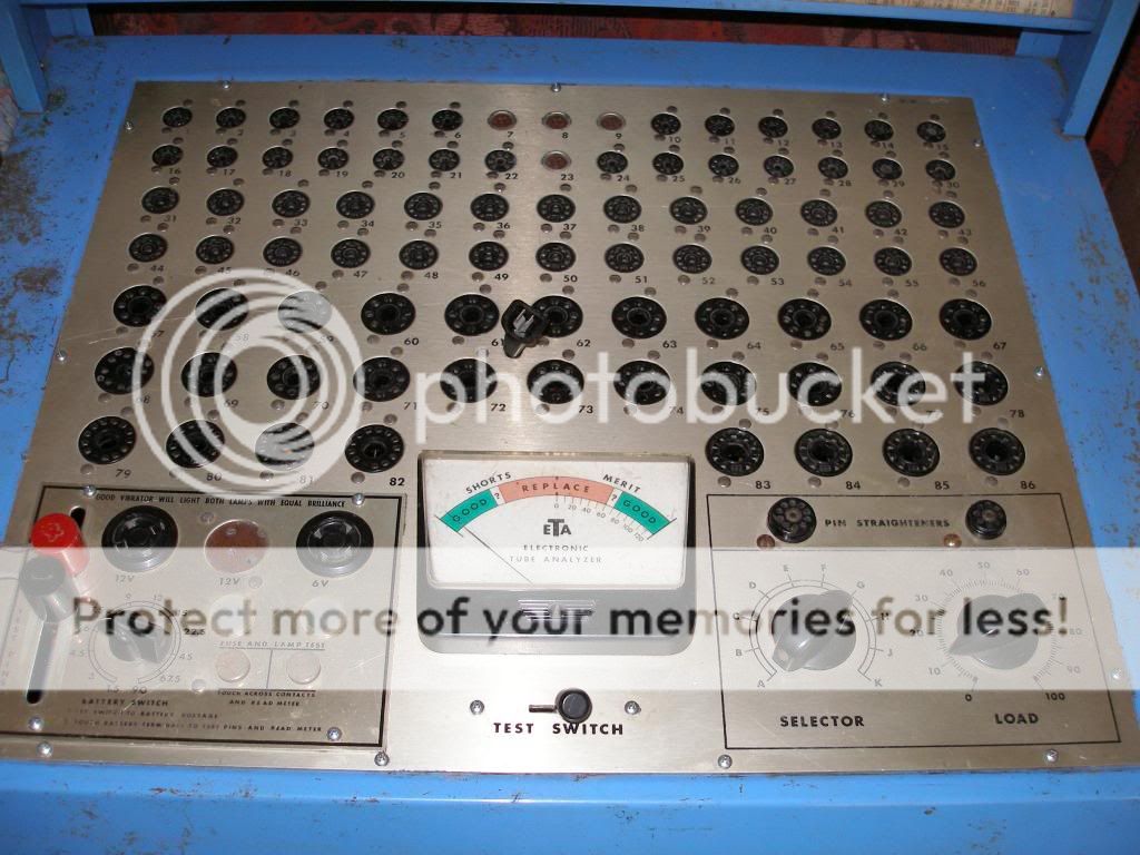

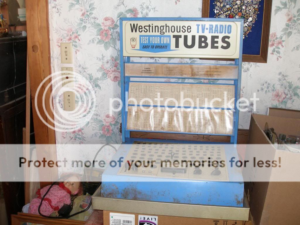

Hello,
Does anybody have any service information for a Seco model 1000 / 3000 "drug store type" tube tester ! I purchased one yesterday , it appears it is trying to work after sitting for many years , a schematic would be very helpful ! Thanks Lee Petrie, Joliet,IL.

Thanks for your reply, Steve R. , I'm been looking for that Model 107 "schematic" with no success so far ! Looked in BAMA , then looked in Daiigo ? ( they talked about Free Seco Model 107 manuals, but that was a real disaster ) but no luck so far ! I changed the filter cap out yesterday, along with the selenium ( exchanging it with a RS diode , as well as the resistor, to offset the voltage difference ) ! I did discover a "line adjusting pot , directly below socket #82, maybe I didn't need to change the resistor after-all ! So far it is very close to working corectly !

Hi Steve R. Three great "hits in a row" ! Found the Seco schematics , found "dogpile" ( first time I used it ) and then finally, the "official name for the tube tester design , " prewired tester, very few switches , and a lot of tube sockets " , the wiring underneath looks like a phone company switch panel, with all of the neatly routed small wires !

Hi Shawn, A tube chart copy would be nice, but unfortunately my Model 1000 / 3000 is NOT a roll chart but seperate pages in metal frames , much like a " Book Format" ! I was thinking about having them copied at an Office Max ,maybe they could get rid of the "water stains", but I think the pages are longer than "legal size" ! How did that "link" on Dogpile, work out, for the Seco Model 107 ? Lee Petrie

You said your tester was a different model than mine, which is a 1000 / 3000 , do you think it would have the same "set-up" information ? How much are you asking for your troubles , in getting the pages copied and in my direction ? Maybe , laminated at this end, would be far easier to read, than the current "flip chart" (like a book format) towards the rear of my unit) ! Thanks for your help, Lee
