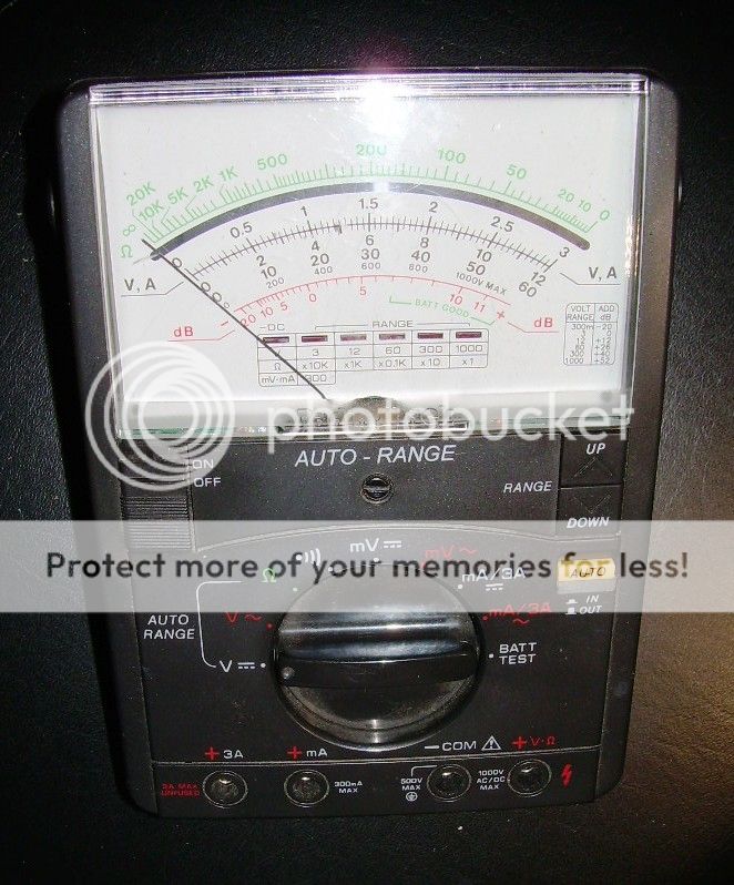

i got this one from the Shack when they had a closeout on them, 22-216 Auto Range, Auto Polarity FET.

Neat Lou.
I followed a link from a discussion to Utube and seen one of these for the first time in action. My only previous knowledge of a service grade auto polarity was the Heath IM-5228, Helper VA502 and the Hickok 370. Only the Helper and this meter I've ever see do autoranging too. Maybe there were others or those that never made it stateside. I never knew that RS sold such a meter and rarely go in one anymore.

Lou deGonzague wrote:
i got this one from the Shack when they had a closeout on them, 22-216 Auto Range FET.
Amazing! I never even knew that there were any auto-ranging mechanical meters made, or that such a device could even be built. That shows how much I was paying attention, I guess.
