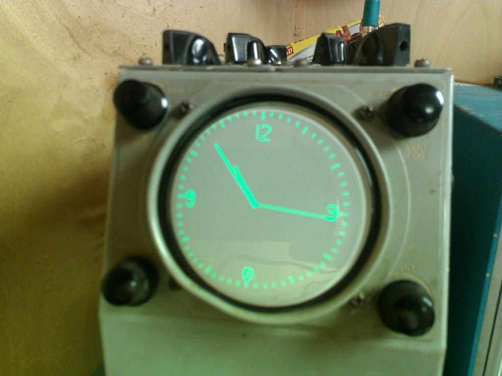

I have had an OS-8 oscope for maybe 3-4 years.
I replaced all resistors, paper & electrolytic caps in all sections except the vertical section.
The scope works ok, but does have vertical issues because I haven't done anything to the vertical section.
The horizontal is ok on sweep or external AC input, but on its DC input as I adjust the variable input control I get this and as expected I have to readjust the horizontal position control.
If I add a capacitor from the horizontal output of the scope clock making it AC coupled I have to reduce the setting of the variable input control in order to keep the horizontal from being too wide for the CRT and I get this and I have to readjust the horizontal position to its previous position.
If I AC couple the scope with the horizontal input selector switch set to 1 I get this, but have to reduce the variable horizontal input more. Not sure though if the DC coupling is the same as the AC coupling is on 1 (dc coupling just has one switch position) or if it is lower than when AC coupling is set to 1.
Seems to me like one of the tubes in the horizontal maybe has mismatched sections or perhaps I have a bad tube, but that doesn't really explain why I get the second picture when the scope is externally AC coupled unless something is wrong with the dc balance circuit.
I don't quite get the dc balance circuit either as it uses a 10 meg resistor right after the 2 meg section (AC coupling and sweep uses 3K section) of the dual horizontal gain pot and the DC balance pot connects to the other end of the 10 meg resistor and the dc balance pot adjusts the dc voltage on the grid of the first horizontal amplifier stage. One would think any dc voltage appearing on the dc coupling input terminal would affect the dc balance, but I see where the dc balance pot is fed a relatively high B+ voltage so the dc input voltage wouldn't affect dc balance at all unless it was relatively high which would be way more than enough to drive the beam off the CRT face. Not sure if the dc balance pot is in circuit when using AC coupling or sweep. If it was necessary for the dc coupled input then it would more than likely need to be in circuit for ac coupling and sweep.
I'm using a 3RP1A CRT if that makes any difference.
In the past I think someone had replaced the vertical AC coupled input with a BNC jack. I might do the same to the horizontal AC coupled input jack only if I decide to use this scope as a slave oscope clock display as the clock board is inside a Heath student model oscope which is also the main display.

I really suspect your clock circuit driving the scope is not centered around zero volts. It more than likely is
offset to one side of zero. A basic/simple scope like the OS-8 just may not be able to handle this much offset.
This would also explain why AC coupling makes your clock face look better.

In reference to your AC coupling picture and comment. The horizontal AC gain and DC gain are the same.
In the DC mode, the switch just shorts around the AC coupling capacitor. The verticle AC / DC is entirely different.
The fact that you had to decrease the horizontal gain when you switched to AC tells me you had to overdrive
the horizontal in DC mode to try to overcome whatever was causing the nonlinearity. DC offset or tube problem
or design limitation.
You asked why they provided DC coupling. Who knows what they were thinking or were required to do for the
mil contract. In this case DC coupling was free. The amplifier had to respond to near DC for very slow sweep speeds.
DC is also required if the horizontal is driven with low frequency square waves or even low frequency sine waves.
You must realize too. The DC voltage applied to the input has to be within the scope's amplifier capability to bring
the trace back on screen. This applies to both horizontal input and verticle input.

I think if you get your scope working properly it will handle the DC input just fine. Scope DC
input means just that as long as the DC offset is within it's capability.
From what I understand in your last post, you are running your clock output signal through
a capacitor into the scope DC terminals. This tells me you are not driving the scope with
too much DC offset voltage and that the scope really does have a balance problem. Just like
mine had until I fixed it this morning!
I decided to check the DC balance by mechanically centering the horizontal position control and
then observing where the spot was. With correct balance it would be center screen. It was way, way off.
I knew it was off yesterday but it didn't register how much until I checked it today. The internal
balance adjust pot was sealed at the factory to prevent someone from messing with it. So before
I broke the seal to adjust it, I decided to swap tubes. The 6J6 driving the CRT had very little effect.
The 12AT7 driving the 6J6 had a huge effect. In fact the spot was at center screen with the H position
control centered. I didn't have to mess with the internal balance pot.
One of the 12AT7 triode sections must have been weak.
I then went back to sweep mode and applied a sine wave to the verticle input and the nonlinearity I
mentioned in a previous post was entirely gone.
I suggest you check your DC balance as above or just swap out the tubes and see what happens.

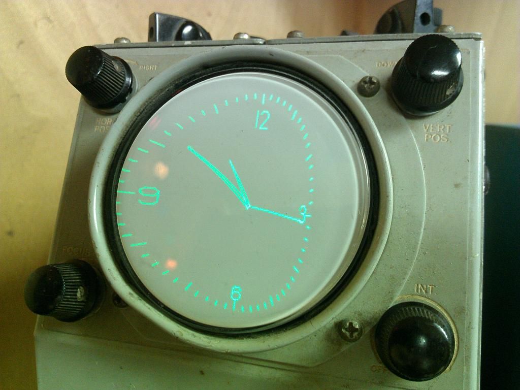

I used the capacitor as a test to see if there was something wrong with the dc coupling input since it is separate from the AC coupling.
Forget what value of capacitor I used as I just grabbed one and it might have been too high a value for the scope's input impedance which I think means the charging current would be enough to make it appear as though I had directly dc coupled the clock. I'll try again this afternoon with a small value capacitor and see if I get the same results.
If using the capacitor then straightens out the display on dc coupling then I'll know the scope just cannot handle the clock board having dc on its outputs.
I think the main reason the scope clock has dc on its outputs is because it has a burnin prevention feature that shifts the display slightly at a user set interval from 1-6 minutes or the feature can just be turned off.
EDIT: Just looked at the manual and saw where the BNC jack for the AC coupled vertical input was stock.
Also reading the manual AC voltage can be applied to the dc coupled inputs, but its bandwidth is determined by the vertical or horizontal gain controls so it could be the controls having something tio do with the display issues when using dc coupling.
I can adjust the refresh rate of the scope clock board (special firmware available on request from the designer) so I may try a low refresh rate and see if the image improves any on dc coupling.
Tried a smaller capacitor and that didn't help anything and I tried the cap I used yesterday and there was no dc on the output of the cap.
With the clock directly connected to the horizontal dc coupled input if I have the horizontal gain set to full the horizontal position is affected.

Swapped some tubes and got some improvement so when I get done with the vertical section I will be ordering a new set of tubes.

I would be inclined to leave the seleniums until they cause problems. What I have noticed is that in very low current
applications, such as your scope, they last a lot longer or their problems are not as noticable.
With the horizontal gain set to maximum you are likely driving some tube into cutoff and or saturation and this
could affect position.
There is a bias set pot for the 6J6 that drives the horizontal plates. You might try adjusting this to see if you can
get more drive ability and see if the clock display looks better. Mark the position of the pot wiper so you can get
it back to original if the adjusting doesn't help.
