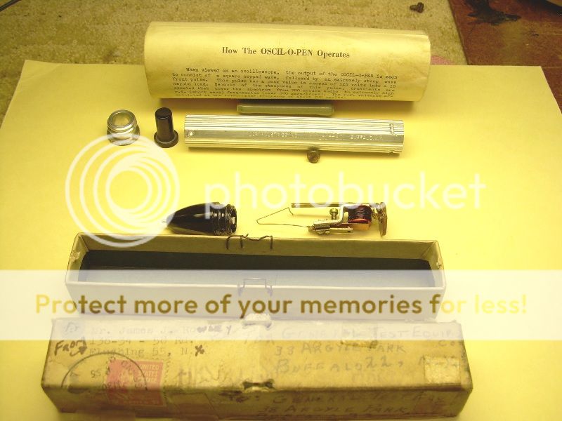

Here is one that is just mechanical

I should certainly like to add an electro-mechanical signal injector, like the one Lou has shown above, to my collection. It seems that the probe type buzzer injectors were made only briefly, before transistor circuits took over. But the concept originates over a century ago. Professional grade crystal receivers and wave-meters were often provided with a little battery operated buzzer (usually a Century or equivalent) to facilitate adjustment of the crystal detector.

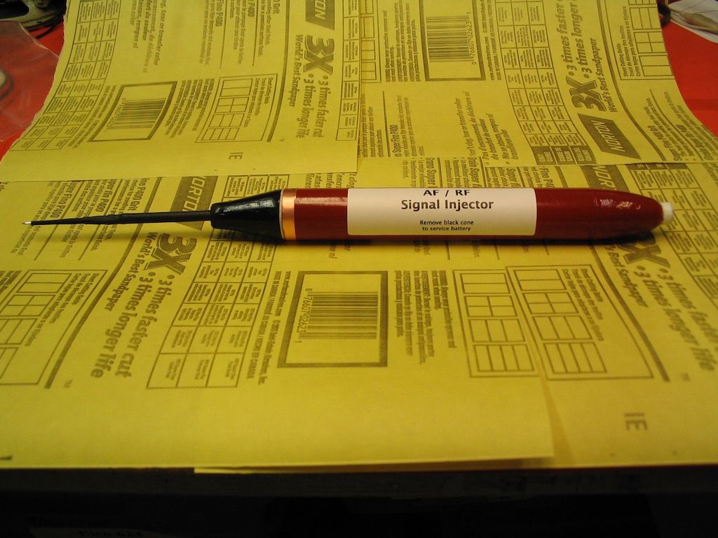

I found a small project box in my junk box and a blank PC board with solder pads. Built the circuit with point to point wiring. Used a terminal post for the output so I can use a probe, wire, alligator clip or whatever to connect to the radio. Being a pack rat I found a surplus Blackberry charger in my stash. Perfect use for it since it is 5vdc and pretty small. Decided I did not need a battery operated pen sized device so this should work for me. Checked it on the scope and looks like the circuit is working properly. The only part I had to buy was the transistor. Had everything else as junk / spare or in my regular parts inventory.

That’s excellent work. Your circuit has considerably less decrement in the ringing (in other words, a more persistent R.F. waveform) than most of the Micronta style injectors I have tested. I am pleased to see the original germanium transistor.
Although I have assembled a reasonably comprehensive collection of vintage signal injectors, I have obtained an anodised, extruded aluminium case to construct a Micronta style injector from scratch, to optimise the function, as you have done.
This is an excellent, simple project for any-one interested in restoring or repairing vintage radio sets. The usefulness of a signal injector can not be overstated. And this particular circuit produces a waveform very like that of a spark transmitter of the wireless era.
