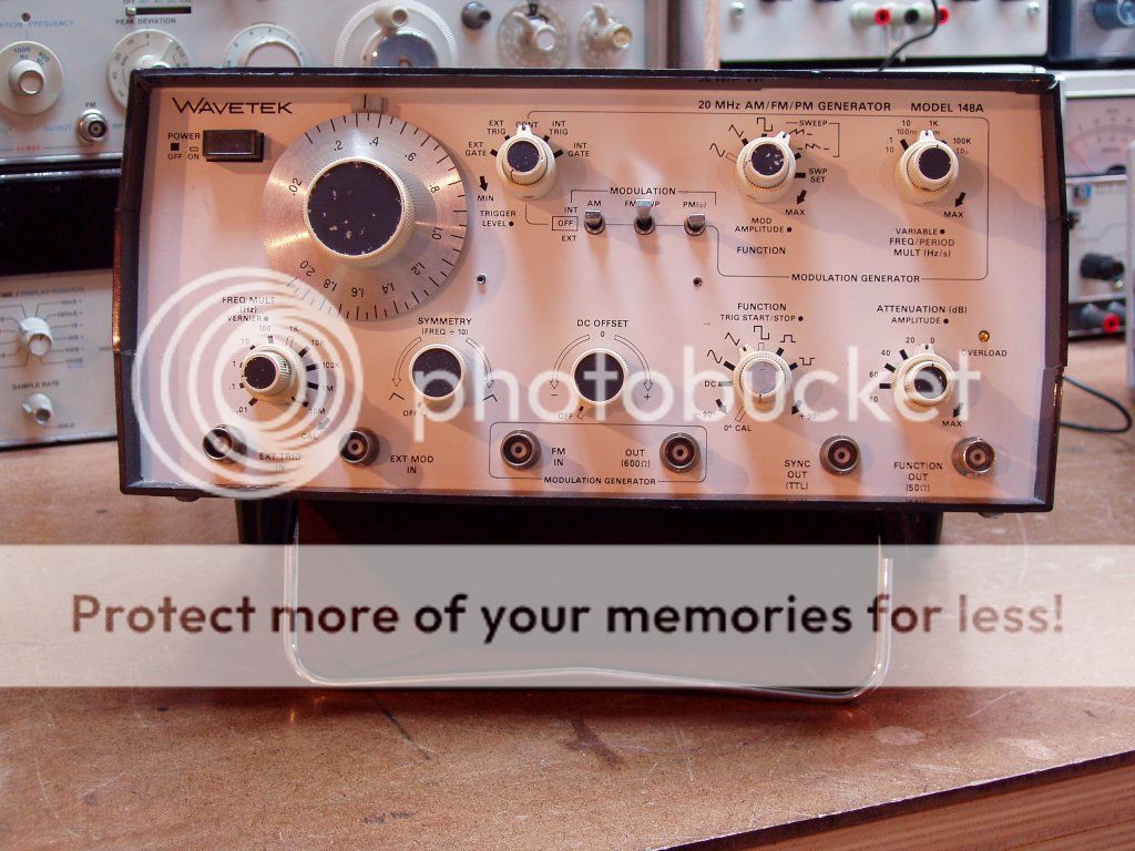

I have one of the Wavetek 148A function generators. Nada-zero-zip ventilation for anything inside the plastic case that serves as the backbone for the whole thing, and after a few hours of use the top of the case gets awful toasty to the touch. I'm sure this contributes to a lot of the failures with these style Waveteks. This is where I don't mind listening to the HP 3325A FG's cooling fan, because I don't think a single repair has ever been done to the HP since it was made in '77.

Interesting, the 148A looks like a very useful piece. Power is listed at 40W, so it would get warm. My 185 is listed at 25W and gets only slightly warm to the touch.

The 148A has some interesting features you don't find on many function generators, which is why I bought it as surplus from the college I work at and keep it at the service bench. :)

At first glance its a bit impressive, but performance is another matter. Used it for a couple days and it was back on the bay.Image

I got my 148A for $20.00 just to keep as a spare FG, and took it because it looked like the college hardly used it and I really didn't want to see it go to salvage. I knew it would in no way compare to the HP 3325A I have and of course it doesn't. But, in the Wavetek's defense, it's one heck of a lot better than the Heathkit IG-1275 I had in the past that is similar to it. At least the Wavetek will stabilize good after an hour warm up. The 148A can add a variety of different types of modulation to the signal, and they included a mod output so it can work as two individual function generators in one. The upper 2-20 MHz band of the base FG is nasty though, I surmise it is harmonically derived, the lower bands are OK. It's not what I consider a piece of lab grade gear, but I've seen and dealt with a whole lot worse.
