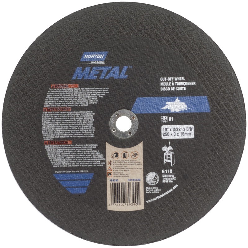

This is what I use. Norton 6110 metal cutoff wheel available at Lowes. Watch out for flying sparks!

Those Norton cutoff wheels are for ferrous metals only, not for aluminum. There are no sparks when grinding aluminum. The number you listed 'Norton 6110" is the max rpm, not a model number.
Do not use such a wheel for aluminum, you will ruin the wheel and your work piece.
Thanks for the correction and advice. I've used this wheel mostly for cutting through rigid 3" copper RF transmission lines when installing FM transmitter antenna systems. It worked great. I've also used it on relatively thin aluminum chassis but you are probably right about not using it on thicker aluminum like rack panels.
