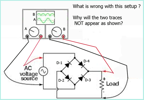

Here's a question about scope basics that I think I displayed maybe a few years ago... but I'll repeat it here again because it's one of those things we do quite often without thinking ..... and then we get a surprise.
The goal in this set up was to compare the input AC sinewave to the pulsating DC wave-shape across the load.

The ground of channel A & Channel B are usually connected together in the scope and would short together the two nodes being tested. A very few scopes do have isolated inputs and would not short the channel A & B returns.
I have never found a dual channel scope with separate grounds for the probes.
But that's the problem here, yes,... the two ground leads will actually create a dead short across D2.

How many of you readers caught that problem?

The more common trap is on a non-isolated supply, hooking the scope ground anywhere in the circuit will fry things.

There is an easy way to make isolated measurments with most
good quality dual trace scopes (Tek, HP, maybe others).
Select 'A+B", then 'Invert A'. The result will be a channel A
minus channel B measurment, aka differential mode.
No need to ground the scope to anything.
However you won't be able to make a dual trace measurment.

Assuming the "AC source" in the original question is actually a power line, why would you want to view it on a scope, while looking at the rectified load-side voltage?
An isolation transformer or a floating AC plug would not help in my example.
Because even if the whole set up was battery powered or whatever won't matter.
... the problem is that the two channels inside the scope have their ground leads common. So the two leads would be like one long wire shorting across D2

Who knows.. perhaps when troubleshooting noise problems in a power supply?
But quite often the problem is that while using dual probes we may forget that the two ground clips act as a common wire and especially when using a bridge rectifier it's easy to overlook that the incoming ground is not the same as the newly created circuit ground.

I agree with Leigh.... it is sort of obvious. I have just sort of gotten into the habit of thinking about grounding issues every time I get out the scope.... saves me a world of hurt.
One thing you could do to make the measurement desired in the first drawing (and this assumes that the AC source is the AC line) is to connect only one probe to the output of the bridge. Set the scope to line trigger and the second channel to "Trigger View".
I do use the ground isolator adapter on my scope from time to time. In particular, when I am trying to observe the output of my Swan 350 with a two-tone test signal applied to the radio.
It seems that the Swan power supply returns the filament current (as well as the speaker and the B-) from the radio to the power supply on a common ground lead. This not only results in hum in the speaker at all times, but the radio is now above Edison ground by a noticeable amount. The result, when using a directional coupler to get the scope sample out of the coaxial output line on its way to the dummy load is that a ground loop is formed through the sample coaxial shield to the scope input and then on to Edison ground. This ground loop couples enough AC into the scope input to render the scope display unusable. Since I don't own a large isolation transformer, I use the simple solution - float the scope Edison ground.
