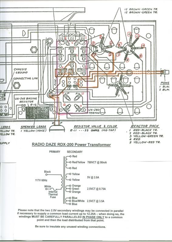

This set is just the broadcast radio, no record changer to deal with.
The amp chassis has a spot where an automotive type tubular glass fuse is used. It actually has three in-line clips for the fuse. One side is marked 110, and the other 120. There is a fuse in the clips on the 110 side, but I have not even looked at it yet to check it's value or condition.
After some consideration, I have decided to just replace the transformer, and leave the rest of the radio as is, other than replacing the 27 tube with the 56 and replacing the caps and out of range resistors.
I have fabricated a replacement box for the transformer, mounted the new transformer inside, along with a large hand made aluminum heat sink, and drilled a few holes in the chassis to allow for more air to get inside the transformer box. The holes will only ever be seen if the chassis is removed from the cabinet. The new trans box is just a three sided faux box to allow for good circulation.
I will closely monitor the temperature of the new transformer once the set is up and running. If need be, I will add a cooling fan under the chassis, or under the cabinet itself. The fans available now are nearly silent, and if properly isolated, will cause zero noise in the system.
The only problem I have at this time, is getting the new trans wired in correctly. This being my first radio trans transplant, and with this being a particularly nice example of a HTF radio, I don't want to make any mistakes, so I am seeking help with it. ;)
Below is the new trans hookup info, and the old trans schematic.
The orange lines are the 120v input line current and the associated switch. I know this is the path that carries current to the transformer, but I wasn't sure if it was important how the black and white input wires on the new transformer were hooked in, polarity wise.
The purple line is just a box that surrounds that area of the schematic, and is not wiring related at all. I just shaded it to make it easier to read the schematic.
The old transformer hookups are the wires numbered 1-12 in the upper right.
Any help here is most appreciated.

Better yet, can anyone tell me how to determine how a transformer hooks up? I'd much rather be able to do this for myself anyway, but for now, I would accept some coaching on this unit.
I'm sure it has to do with current demands for each circuit, such as tube filament and plate/grid demands, and I should just put my nose in a book that can give me those numbers, and the associated math. Correct?

Red wires go to pin #2 and #3 on the 80 tube. Red/Yellow goes to ground/chassis.
Yellow wires go to pin #1 and #4 on the 80 .
Orange wires go to pin #1 and #5 on 24's and other tubes. Do not use the green center tap.
Blue wires go to pin #1 and #4 on the 45 tubes. Do not use blue/white wire.
Black and white are for AC input. These connect to your switch and line cord.

Thanks Norm,
