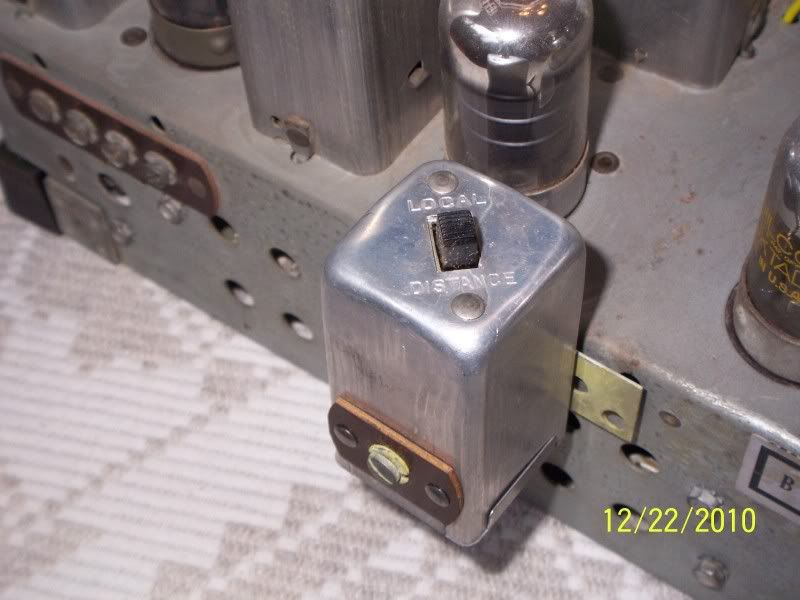

PostPosted: Dec Thu 23, 2010 12:37 am
Posts: 5674
Perhaps these photos of the chassis bottom and closeup of the band switch on my 41-250 will help encourage you and others to complete the rewiring:
You will need to modify the replacement plastic escutcheon, unless the molds have been corrected. I used a brand new and sharp 1/4" chisel to very carefully shave away the molding error which prevented installing the paper labels and clear plastic covers:
By the way, if you are wondering about the small socket which accepts three round prongs, it is for the Philco external antenna adapter:
Many of my radios are on my http://www.photobucket.com account - FStephenMasek.

FStephenMasek wrote:
Perhaps these photos of the chassis bottom and closeup of the band switch on my 41-250 will help encourage you and others to complete the rewiring.
You're ahead of the thread, but no encouragement will be needed here. Changing out all the bad wiring is certainly on the agenda, but it'll come later on.
I have to say that you did a bang-up job on that chassis. Looks terrific. The soldering is first-rate. Congratulations. I hope mine turns out half as well.
