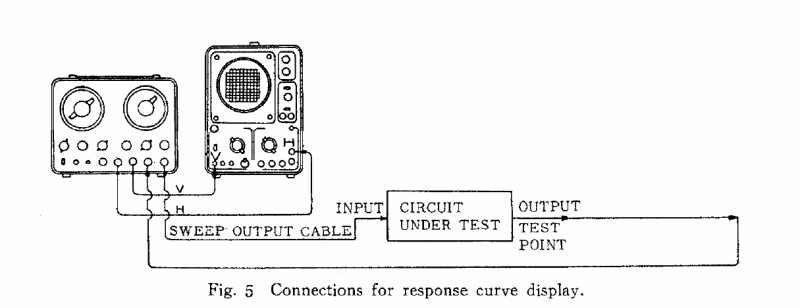

I have never used a Sweep marker generator before, so bear with the noob questions :)
I have recently acquired one and have tested the basic functions and found it to be functional (as far as I can tell). My testing consisted of looking at the output of the marker and sweep generators on an oscilloscope and everything appears to function properly. When looking at the marker output, I see a sine wave which changes in frequency appropriately with the use of the range and frequency controls. The amplitude of the sine wave changes appropriately when the marker-size knob is turned. As far as the sweep generator output, I am not sure what the correct appearance on the oscilloscope should be, but this is what I see: With the oscilloscope horizontal sweep set at slow speed, I see a flat line alternating with a rectangular box something like this ----|||||----|||||----- . The width of the rectangular box changes appropriately when turning the sweep-width knob and the height varies when the step and fine attenuators are turned. When the sweep output is fed back to the input of the sweep marker generator and the horizontal and vertical outputs are connected to the oscilloscope in X-Y mode, I can see the marker pips on a flat line. So far so good.
Now for my question: When I connect the sweep output to a 455 kHz IF transformer and feed the output from the transformer back to the sweep generator, I still see a flat line with the marker pip just as when the sweep output is directly fed back to the generator. I was expecting to see a curve with the peak around 455 kHz. I tried varying the center frequency on the generator but still see only a flat line. What am I doing wrong? If using an IF transformer is not appropriate to test the functioning of the generator, what device can I use to obtain the curve with the marker pips that I have seen in pictures?

gmcjetpilot wrote:
... Pictures, sketch info would help.
Here is how I have it hooked up..

Don_S wrote:
The sweep generator is a Leader LSW-250. I do not have a demodulator probe.
I was not testing the IF transformer in a radio. The test was performed on a spare IF transformer that I had on hand. That shouldn't make a difference, should it? The frequency response of the IF transformer should be the same whether it is in the radio or not, No?
Yes Freq response is the same but the impedance is not. By connecting to the primary with the signal gen you detune it. In the radio you don't connect to the primary of the transformer, you connect to the tube before it. It kind of works but you will not get a pretty classic band pass response. Also as was pointed out not many sweep gens will go down to 455 Khz. This is for FM radio and TV.
There was a recent post on RF Probes. Cheers.
As to your picture I got it! This is a solid state version of the Eico 369. It is post injection marker which is good. Should work well. If you don't have the manual for it, down load the manuals for both the Eico 368 and 369. The 369 adds post injection markers to the 368. These manuals (BAMA) will help you greatly, but try and get the original manual. It is a great help when learning. Also you should get a FM tube radio to practice one WITH VISUAL ALIGNMENT INSTRUCTIONS. I find that Sam Photo Facts to be invaluable for this. Some of the factory instructions give you the "Visual Method" but most do not, especially Zenith.
To TEST there should be a TEST SET UP in the manual. Just looking at your picture, you would replace the TEST POINT OUT cable going from the DUT to the LSW-250 with a demodulator RF probe. The DUT is not there. Then connect the RF probe from the SWEEP CABLE OUT to the RF probe. You should get a rectangular box on the scope with a marker. This should give you some info as far as the test set up. (This is for the Eico 368 and does not have post injection markers, but it shows you were the "demodulator" or "detector" or RF probe goes.)

The issue here appears to be that you are feeding the swept RF output of the signal generator (with or without the IF coil in line) into the oscilloscope. If the scope is capable of responding to the RF frequency directly, you'll only see the RF, not the characteristic curve of a tuned circuit.
The input on the generator is marked "Rec TP" (receiver test point), which is usually after the demodulator or detector stage in the radio or TV. At that point, the RF is gone, and there should be a DC voltage that varies in amplitude at the sweep rate. The amplitude at any particular instant corresponds to the frequency response of the circuit you are sweeping, so the beam of the scope traces out the frequency response of the circuit over the range of the sweep.
If you want to use this unit to test coils, you need to provide an external detector or demodulator. The subject has been covered in great detail recently on ARF, so if you do a search on "demodulator probe" or "detector probe," you should get plenty of good background material. These devices can be nothing more than a germanium diode and a resistor, or they can get quite elaborate. They're available commercially as well.
To verify if this is the problem or not, try injecting a small amount of DC into the "Rec TP" jack with the scope running. 1.5-volts DC from a penlight battery should be sufficient. What should happen, when you connect the battery, is the trace on the scope will jump up or down vertically. It's OK if the trace doesn't stay up or down, because the circuits may well be AC coupled, and once you've charged the capacitors with the battery, nothing more is going to happen.

Go to the BAMA web page and down load the Eico 369 manual
On Pdf page 8 (page 7) you will see the test set up.
On Pdf page 9 (page 9) you will see the classic test pattern.
The test pattern is a flat line. Unlike you previous test where you see the Sine wave getting closer, low Freq changing to high, the RF probe converts it all to DC. Thus you get a flat line. This level amplitude, level across the Freq sweep the key or characteristic of a well working seep Gen. Any slope will cause distortion in your band pass. The wider sweep width and flatter the better. This is as perfect as it gets (forgot the sweep freq and width but it's pretty):
