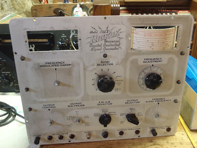

Gents, I'm in the same Hickok boat, but five years later :(
Based on this thread, I think my set would be either the 288AX or the 288X J,K revision. I also have the V2-6SN7 w/47k resistor. I searched the gallery, but did not find schematics, nor did these appear to be on BAMA. (I do have the 617W schematic).
I know this was an old post, but do any of you gents still have electronic copies handy?

I have the schematic from the instruction manual available on BAMA. My set does not have the same wiring, and a few different parts, etc.

Thanks MAG and EasyRider8 for the schematic versions for the 288.
It turns out that mine is electrically a 288AX (matching the 999w drawing), before they changed to the newer-style cabinet. Recapping now, and testing everything prior to power-up...

I just picked one of these up at a swap meet.Does the paper wheel on the right have a cover? Mine doesn't and is getting soiled. Mine came with a copy of the manual with color cover and end sheets, so it seems to be off an original, not a PDF. I haven't cracked it open as I am still working on the tube tester 533A.
I have a HP, but the Hickok sure is a better looking machine. And it has a manual. Any thoughts on which is better? I do not want both and being a noob the manual means a lot.

Yes, it should have a cover, bakelite escutcheon and the cover has the band numbers stamped into it. You might start looking for a parts-set.
Mine came with a manual too, but I soon found that my set was electrically different. If you find this to be the case I can forward on some schematic versions that other members sent to me. I was unaware Hickok would make design changes on-the-fly without changing model numbers (and ostensibly failing to note this in the manuals).

First off, ARF is great! Found a thread discussing my exact situation. The schematic I have is Alteration B. My situation is around the dual 20mf electrolytic C31. R22 is there but there is also another resistor in series with it before connecting to the other half of the cap. Its value is 620ohms.
Does the alteration C drawings have anything to do with this?
There are only 2 lugs on the cap so am I to assume that ground is internally connected to the can?

The later military model used 2000 ohms there. Perhaps the previous owner was compensating for higher line voltage. The higher resistance won't do any harm, so you may as well leave it.

Thanks Allen. Feel better about that. One more question about that particular area. Anymore questions I have, I'll start a new thread. According to the service instructions, I should get a reading of 150v for the power supply voltage. I'm reading 205v (just after the 1.8k resistor). And 270v directly off V5 pin 8.
