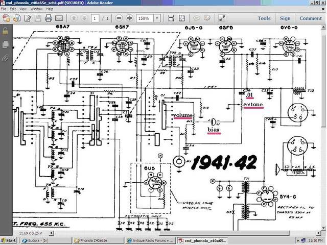

I am just finishing up a Canadian Phonola and everything is recapped, out of spec resistors removed, aligned and thoroughly cleaned. The radio is working well but I still have low volume at zero volume level. At one point during the recap I know the volume control was fully functional. The pot has been cleaned, C34 has been replaced and R11 checks out alright.
Any ideas?

When the control is all the way to the low position, do you still show some resistance? If so it may be normal

Did you change the bias cell ? It might be dried out and acting like a very small capacitor leaving
the grid of the 6FS5 open and subject to crosstalk from adjacent wires to the top of the pot from the detector.

I think Steve's on the right track; there's a high probability the trouble involves the bias cell.
This link explains them and gives a method to try to rejuvenate them:
http://www.philcorepairbench.com/biascell.htm
The circuit arrangement is a little unusual in that the bias cell is directly in the path of the audio signal.
If the cell cannot be brought back to life or made to operate satisfactorily, the usual thing to do is to eliminate it with a circuit modification as shown below. This relies on the grid to develop it's own bias through it's "contact potential."

I don't believe the bias cell can cause that problem. If the resistance from the volume pot reads essentially zero at minimum setting, there should be no signal leakage through the cell.
Since you have recapped it, and this is quite a high impdance circuit, subject to pickup, I wonder if you might be getting some accidental capacitive coupling in your wiring. With the volume turned to minimum, can you change the audio level by poking around the wires in the vicinity of the VC?

I think Steve's idea was that with a dead bias cell, there would be zero bias on the grid. Then the gain of the tube would be very high and overly susceptible to stray signal pickup through accidental coupling.

I metered out the 2 Meg pot here today and I am getting about 22 ohms at zero volume level from the pot. I removed it, recleaned it and reinstalled it and yet I am still getting the same ohm readings and low audio when the volume is at the zero level.
Can I therefore eliminate the pot as the problem and proceed to looking at the bias cell? If I go with Terrys idea of bypassing the bias cell with a .01uf and a 5 Meg what wattage resistor should I use?

Problem solved! You guys are pretty smart
I removed the bias cell and modified the circuit as per Terrys diagram and the volume pot works perfectly now. I used a 4.7M 2W resistor; from what I have read that part of the circuit is lower volatge and current anyways :wink:
