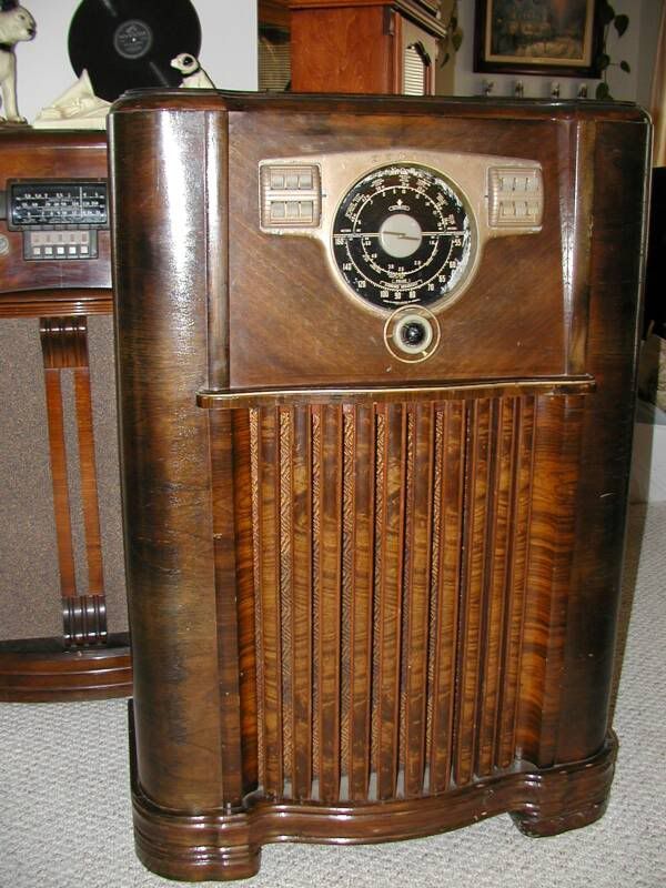

Location: Levittown NY
I bought a zenith awhile back like this one that has the photo finish on the front speaker grills pretty well destroyed I was thinking of trying this product to redo it.The burled wood grain looks good for some other radios I have too.
http://www.berlinwallpaper.com/dcfix/Woodgrain.htm
