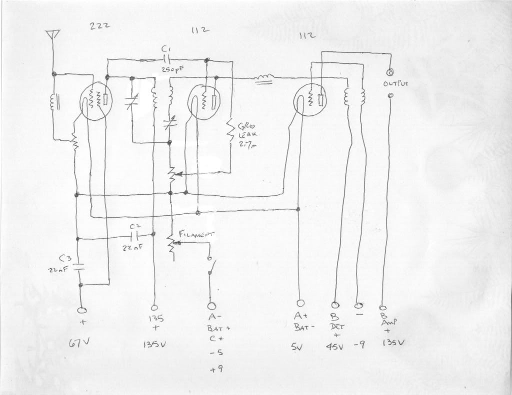

Years ago I bought a HomeBrew battery radio and have never been able to get it to play. I have tried hooking it up many times and some folk here have tried to help. I knew I needed to draw up the circuit to try to make sense of what was there and maybe allow others to advise on how I could get this radio to play. Finally drew it up. I have added the voltages I used listed near the terminals. All I get right now is a loud whistle which is linked somehow to the heaters. The pitch changes as I alter the filament voltage.
I don't even know if this radio ever worked. I am also wondering if I should build a radio that would work using the parts I have instead of trying to reverse engineer it.
So looking for insight.

Fantastic! I like it. You even used the old school tube symbols. Good job. I have examined your circuit and it looks to me like it's a regenerative scheme (feedback via capacitor C1)with no local oscillator and hence no super-hetrodyning or resulting IF stage. A receiver of this type, just like a crystal set, would "hear" several stations at the same time. Since in this day & age there are so many powerful and closely spaced stations, I would probably build something that includes a local oscillator and subsequent IF stages. If it ever originally worked, probably not well since there is no RF coil tuning. I'm a bit perplexed as to why anyone would attempt to tune plate circuits. Looks like you have the Tiger by the tail. Nice cabinet!

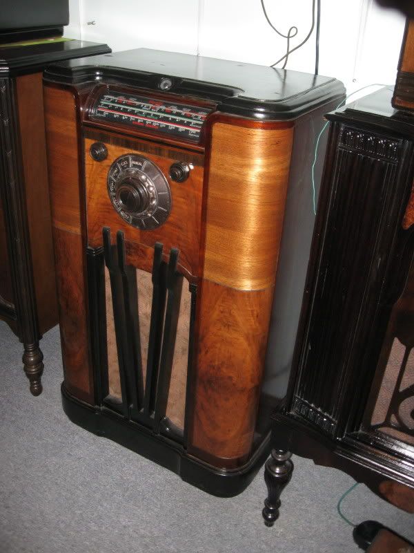

I'm more interested in the radio below it. What do you have there? Could you take a better photo?

Thanks - but would it work?

I'm having trouble following the battery connections.
"A" battery is 5 Volt, "C" battery is 9 Volt, and there are three "B" batteries, 135 Volt, 67 Volt, and 45 Volt. Ok.
I presume the "-" on the same term as -9 Volt is C- and I see A+ and A-. Where is B- and what is Bat+ and Bat- ?

It's obviously an unfinished project, and it will not output anything intelligible from what I can see. Where did you get this?

this radio could never have worked as drawn;
(1) your tuning cap is connected at one end to the primary of the rf coil and at the other end to the secondary of this coil.There is no tank circuit to
tune a station to resonance.
(2) There appears to be no ground anywhere on this radio.
(3) There is no rf bypass cap at the plate output of the detector. The rf can only feedback to the filiament circuit. This might be the reason why the pitch changes as you alter filiament voltage.
(4) A grid leak always bypasses the excess negative bias on the detector grid to ground. I dont see that happening here. Also, C1, instead of biasing
the detector grid appears to be feeding all the plate energy of the preceeding tube (which is completely untuned) to the detector grid.
I am not a radio engineer so some of my observations could be wrong. Maybe someone could confirm or refute some of this.
I think this radio could work if rewired correctly.

I'm not up on receivers either, and don't understand how the front end was intended to function, but the detector looks workable to me. C1 feeds RF to the grid but the grid leak should have it biased near the onset of positive grid drive so RF peaks will clamp there and if the envelop varies, I.E. AM, then bias shifts with the audio, and so does plate current. If the plate choke is then appropriately sized to block RF, but pass audio, we have audio passed onto the output stage through the coupling transformer with RF remaining on the plate which, I presume, is intentional for regen back to the front end I don't understand.

I picked this up years ago, tried to draw the circuit but could not. Just recently opened it up again and set it to paper. I could not see how it would work either but drew it up as I bought it. Cabinet is nice though. Will look for a circuit that I can put in there that uses the 2 variable caps and 2 pots as I would like to keep the front the way it is. Anyone have a simple radio circuit that I could use?
I had B- hooked to A+/Bat-. I did not have a B+ hooked up to the A-/Bat/C+ terminal.
The radio below it is a Rogers 7R832. I have refinished it and replaced the top veneer twice now and it is still bubbling so I will need to strip and redo the veneer again this summer. Radio has great sound.
Brian

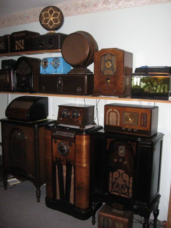

It does have good sound. Here is a picture of the wall that has the radios. I have about 50 spread out thru the house.

Wow! Impressive.
I like the fish tank radio :lol:

That's my wife's fish tank. We have 3 tanks up to a 35 gallon including a salt water tank. I wish this one was gone - it takes up a radio spot.

It's nothing more than an untuned, broadband RF amp- just uses an inductor rather than a resistor on the grid. If it were me rebuilding this I'd make the first RF amp and detector tuned, both in their grid circuits. No reason in the world this couldn't be a decent radio if this were done. If you wanted to get fancy, make the RF amp do double duty as an audio amp- commonly known as a reflex circuit.

Well, yes, I figured the front end was an untuned RF amp and, like you, I'd think it better tuned. It's the odd tank and regen I don't quite get.

If you're not opposed to solid state why not use an MK-484 AM IC. You can still use the two tubes one as an antenna preamp and one as a tuned RF stage. One control can be repurposed as an AGC control while the other control can be the volume control.
You would need to find or construct a couple RF transformers that will allow the stages to be coupled to each other with the secondary of the transformers forming a tuned circuit with the variable capacitors so that the AM broadcast band can be tuned.
