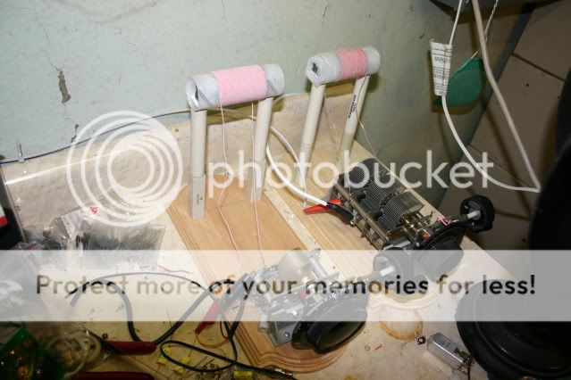

I ran across one of those "at the local supermatket" coil forms that may be of interest. Kroger "Value" brand 2.25 oz pepper comes in a pp (5) plastic bottle with a 'form' diameter of about 1.75" and 2 inches of form between the 'end bulge'. That should be just about right for a BCB coil, I would think, and at a buck it's not a bad deal even for just the form.
 Post subject: Re: What makes a good coil form?
PostPosted: Apr Mon 16, 2012 2:21 pm
Posts: 2755
there is black plastic pipe at the hardware store. the coupling fittings look best. what about ferrite core antenna coil :shock:
CAUTION: Im no expert
PostPosted: Apr Thu 19, 2012 6:15 am
Posts: 943
Location: Texas. USA
I had mentioned the Kroger pepper bottle and here is a coil I wound on one. The second coil is scramble wound on an octal socket salvaged from a defunct tube. Both are intended to be BCB. The pepper bottle has, from the bottom, antenna coupling, primary, and 2 turn tickler. The octal coil is roughly 80 turns tapped 20 from the bottom. I say roughly because I have a LCR meter and, so, 'over wound' it, to make sure, and then backed off turns to get the inductance wanted.
They aren't works of art but, rather, an example of what even an amateur klutz like me can do.

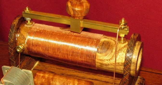

Wood turned to .125" wall thickness. And a wood mount gives it an "old school" look.
