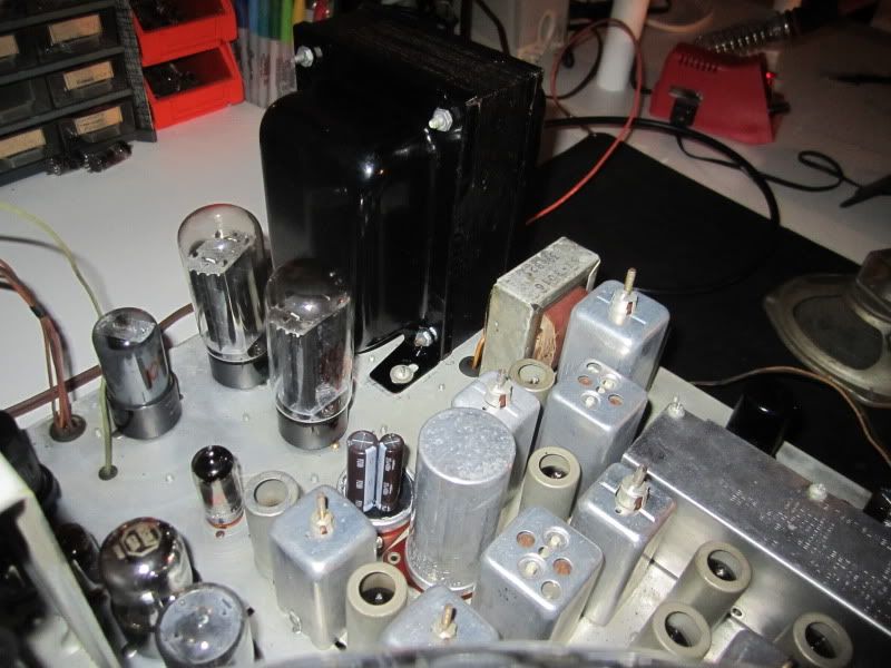

What did you clean your power transformer with to make it look new?
Doug
Doug
Spray Nine. Wash, Rinse, Blow Dry, Bake in Oven 2-3 hours @125 F.
