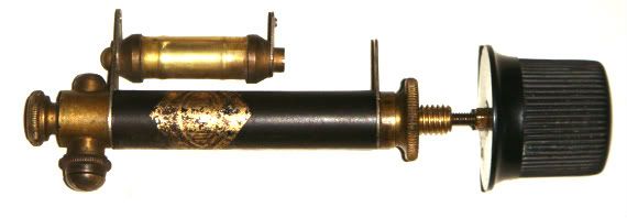

Quite a few years ago, a friend and fellow collector gave me an excellent Dayton variocoupler that I had been admiring in his junk box ever since I saw it. I had planned to use it in a project and began the hunt for other bits and pieces. A few years later I found a matching variometer at a swap meet and I recently acquired a British-made variable grid leak and cap from a collector's estate. A request in ARF classifieds yielded a nice Murdock cased tuning cap. It all came together last week.......
Nice mahogany was difficult to locate locally - so I opted for red oak. Remarkably, I found a single well-figured, quarter-sawn piece at the very bottom of the stack at Lowe's.... it had a small split in one end and apparently had been culled over many times. I fumed the oak with ammonia to get a darker substrate and waxed it. It actually plays well for what it is - there is a bit of a learning curve to tuning such sets... but I'm now getting the hang of it and a range of about 600 to 1250 khz.

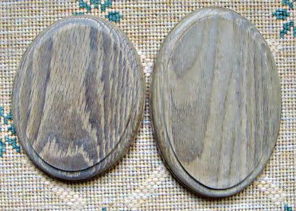

Thanks guys..... It was my first attempt at fuming oak - I'd have liked it a bit darker but it turned out okay. Here is the before and after (compared to a scrap (L) of the same board)....
From what I've read - white oak responds better than red oak.... which seems to be the case on these 2 bases I fumed along with the radio base board....
The base on the left was white oak and that on the right was red oak.... It's a fairly simple technique.
