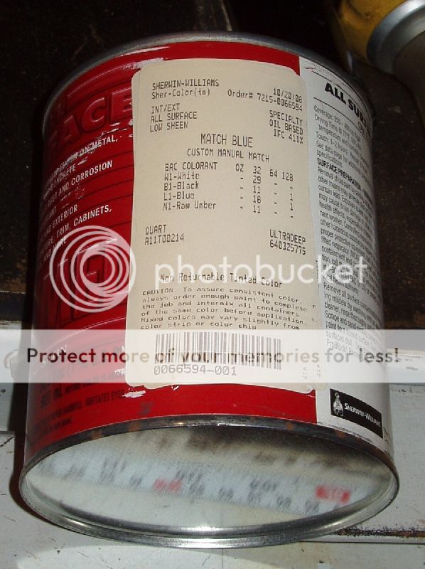

PostPosted: May Fri 25, 2012 12:14 pm
Posts: 3175
Here's my solution for the paint match issue. Plenty of material, easy to use, matches everything but the nicotine hue. As an X-smoker, I prefer the no nicotine, "non-stick" finish. I fine tune the color matching by removing the nicotine from the rest of the piece with regular ole ammonia right out of the bottle.
