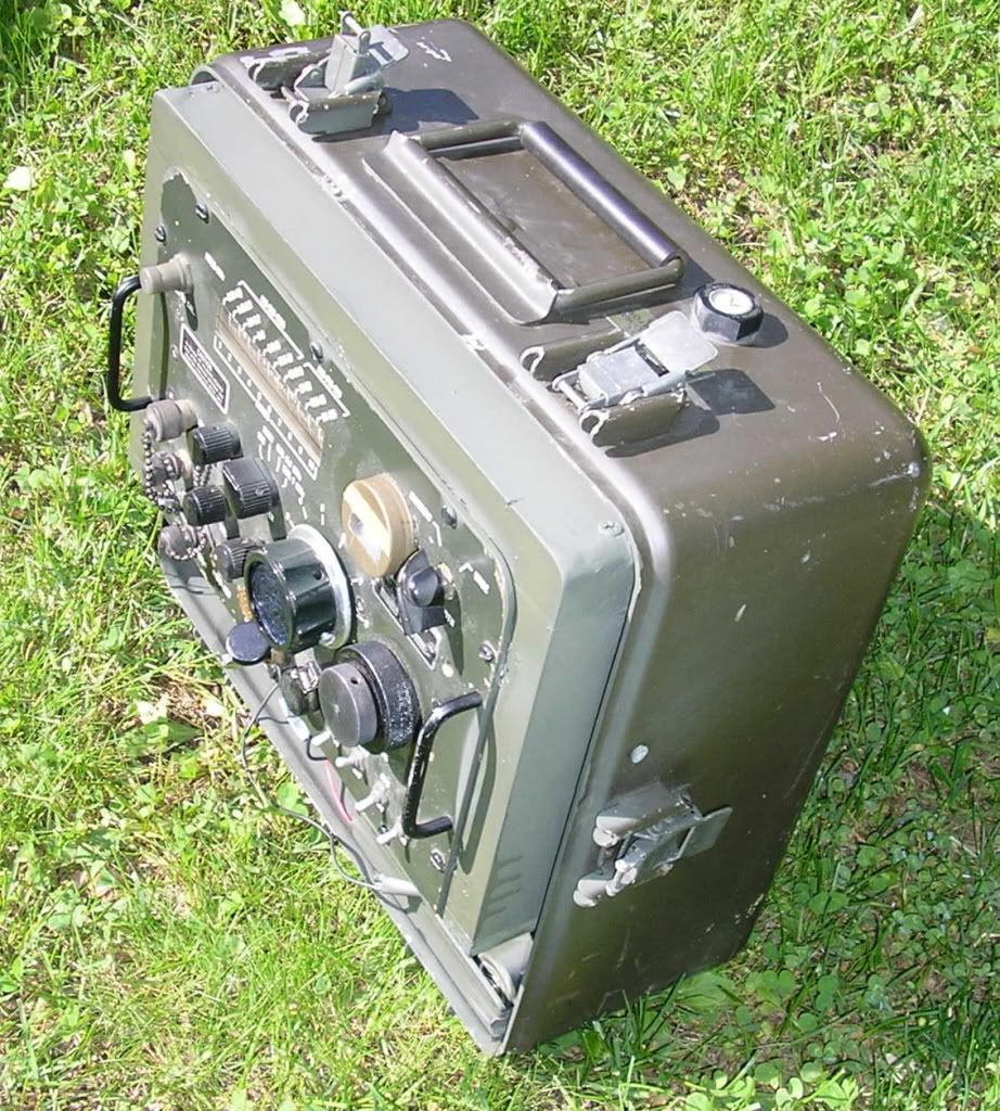

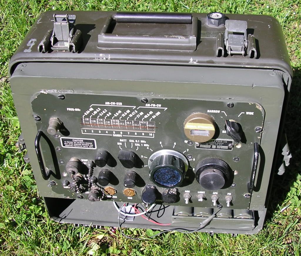

Yes! Here's more pics of the first Chassis, restored, in a military case similar to the correct one, but slightly larger. It has room for a battery case and AC power supply:
CaseOpenPRR-15 Compressed to fit AntiQueRadios new requirement.jpg [ 30.07 KiB | Viewed 1835 times ]
Image THANKS SO MUCH, PHOTBUCKET, for holding my pics for Ransom. GOOD LUCK with that! :evil: :evil: :evil:
The Band selector knob is from a Heathkit, the S meter is home-brew, but she works well and I was out on the patio listening to some hams on 40 meters SSB this afternoon. Lot's o fun!!!
The second chassis looks a little better, has the correct knobs and S meter, but needs more work. So the project continues...
