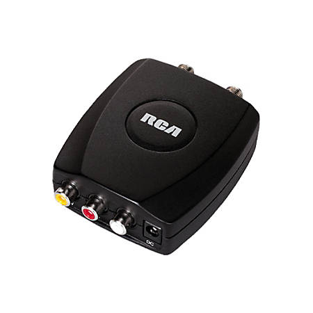

Ok so I'm finally back from turning it on :lol:
https://youtu.be/45PWv4-oUes
The picture is acceptable, but there is a strong hum/buzz in the audio. I have the following setup:
HDMI output -> HDMI to RCA converter -> RF Modulator -> balun -> VHF
Looking about has caused me to wonder:
- AGC fault?
- Possible demodulation or tuner alignment issue?
- Overmodulation? Would an attenuator solve this?
- Ground loop isolator? Unplugging the audio and leaving the video line in doesn't stop the buzzing.

Does the buzz stop when you disconnect the video? See my post about playing copy protected content on vintage TVs.
If disconnecting the video stops the buzz, try reducing the video level a little into the modulator - there may be an adjustment in the modulator for that. If not, shunt the video line with a 200 ohm pot and adjust it.
You may be able to improve matters with the TV's fine tuning control. If that doesn't help, and after you've checked everything else, the TV's sound IF and demodulator may need alignment. DO NOT adjust anything though unless you can correctly identify the coil / transformer and NEVER adjust anything in the vision IF.
I'll need to look at the schematic to give you more advice on this. You'll need the proper tools or you'll break slugs inside coil formers - bad news. Whatever you do just don't go poking around with these things.
Another thing, no matter what anyone tells you, that set is too new to need recapping. Don't even think about it!
I just had a look at your video. It looks like the video level into your modulator is too high, there is white crushing in the image.
Also, do you get a white spot when switching off? Check that the CRT dag coating is grounded - there should be a long spring or spring loaded wire across the graphite coating, connected to ground. That might also affect the sound.
One last check just occurred to me - is the hum / buzz still there with the volume at zero? If so, ignore for now what I've said and look for an open circuit B+ filter capacitor in the audio output circuit.

I was in the office when I looked at your youtube video. I since had a chance to listen to the rest of it, at home.
Yes, definitely, your video level into the modulator is much too high. That's your problem. Try the 200 ohm pot as I suggested earlier.
Or you have a really crap modulator....

Thanks irob2345, I'll try the pot before tinkering with the alignment.
As for the RF modulator, it's an RCA... the badge of quality :lol:

It could also be that the output from your HDMI to CVBS converter is too hot. Digital designers often don't understand analog!
Crack the case of the modulator open. There might be a pot for video modulation level in there. You should adjust it so the peak white from menus displayed by your box doesn't result in hum.
Do read my post on this subject....

I took apart the modulator and found a pot. A bit of a twist and the buzz is gone!
The focus and the picture adjustment can use a little tweak, but I can finally put the chassis screws back in on this now two year old project and put the finishing touches on it.
