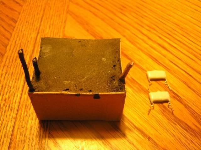

He is replacing the capacitors and will be sending me photos of the work in progress. He has commented that the capacitors on the radio are HUGE, like "bricks" he said.

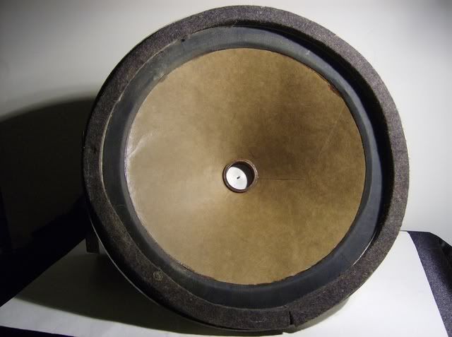

I took a couple of photos of the speaker and put it back safely in the box. Assuming it's original, the speaker is dusty but in great shape for almost 80 years old:

Regarding the speaker, is there something missing in the center? Searching posts on the forums I came across one that said some speakers had something there, some did not.
Regarding the dust, could I take a blow dryer on cold to get rid of gross dust and then a small soft brush on tighter spaces?
On the cabinet, which is much, much lighter without the radio, there are areas on the decorative skirt area and front legs that are pretty much shot and the wood must be sealed to protect it. Rather than stripping, in the bad areas I thought I'd take some 100 grade sandpaper to remove loose remnants of the old Duco finish and smooth out the surface. Since the Duco is lacquer based, I thought I'd try at least a couple of coats of high gloss Deft, also is lacquer based.
PostPosted: Mar Sun 18, 2007 7:01 pm
Posts: 8327
Location: Baltimore, MD
Don't use a blow dryer on the speaker due to the heat. It can warp the cone. Get a can of compressed air from an office supply store and blow out the dust gently. Use a vacuum to get the remaining dirt out with, but be careful not to tear the paper speaker cone.
The center of the speaker looks all right to me. If there was anything there it was only a cover, but a lot of models didn't have them.

Hi,
Newer speakers had a felt in the center to prevent dirt froom going into the space around the center. Older sets did not have a felt.
The way I remove the crud from the speaker centers is like this.
Face the speaker down on a clean surface. Slightly tap the back of the speaker assemble enough to dislodge dirt from the center.
You could put a cloth on the back of the speaker, then use a small hamme to LIGHTLY tap the back so the dirt falls down on the surface.
Then you can try to gently move the cone in and out, just enough to move it, tap again, more dirt might come out.
Then use the compressed air as mentioned above. Tp protect the cone, cut a round piece of cardboard for the front, then secure it to the speaker frame, Youknow that speaker cones have an attraction to tools like a screwdriver falling on them :)

One of the work in progress photos below I have sent to you, the other is of the radio's "dual capacitors."

Hi,
I am not sure how the double cap was mounted, but it could easily hold the 2 new caps inside. That would maintain its original look.
But if you are not going that routem make sure you save these old parts in case you or someone else wantd to restuff this and reinstall it.

Christina, to easily explain the speaker, there is a part called a spider that keeps the cone centered. In the older speakers it was in the middle of the voice coil, and it was subject to dust.
A later development was to use a donut shape spider attached to the outside of the voice coil and a felt disc in the middle. That kept dust out of the moving parts.
